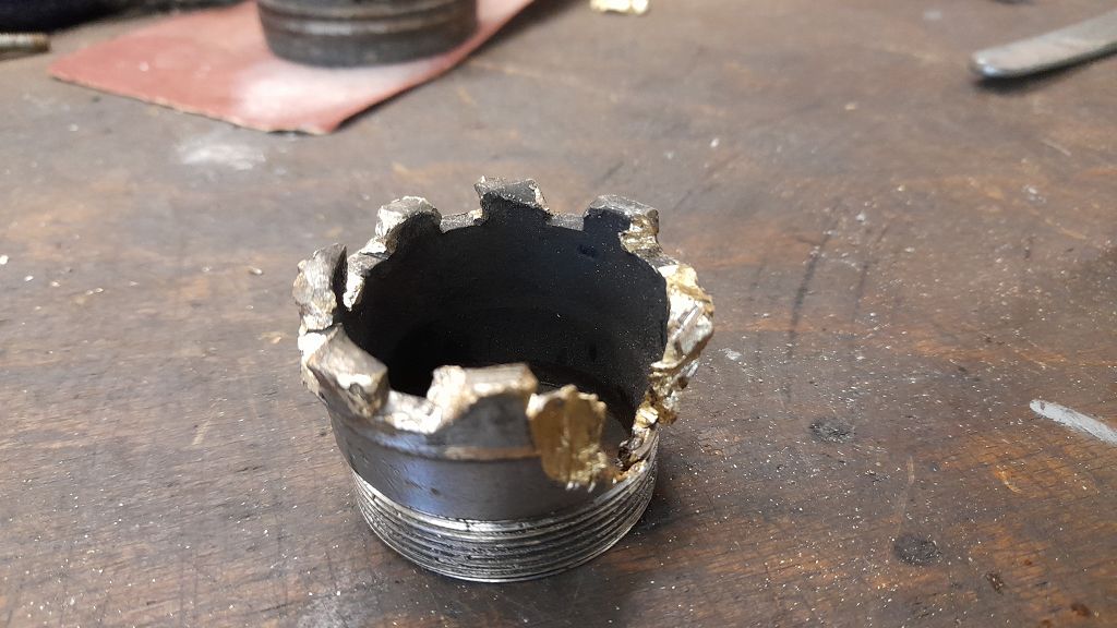

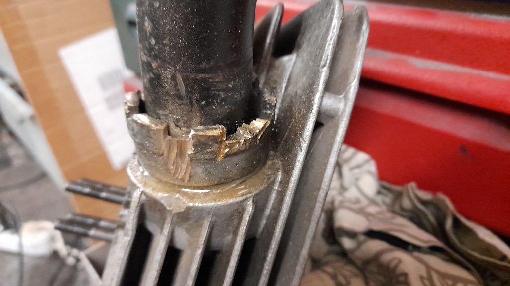

these castle nuts can be stupidly stuck ,
best to get /make a properly fitting tool, the nuts are pretty soft, so easy to damage.
Posts: 935
Re: new toy
Heat, heat, heat! If the motro runs, heat it up properly before destroying the nut. If not try to heat up the head anyhow. Soldering a lever can also be the way to go.
Once I had a highly resisting nut and had tu use a chisel and heavy hammer (of course with the dead in a vice and not mounted to the motor) I´ve heated up the head on a (kitchen) hotplate and it gave me a lot of pain to use that much brutality. Shortly before the nut was absolutely destroyed it came loose. This is a horror picture and probably you will have easier succes. If it resists I would prefer soldering a lever to do the first move (of course you cannot turn the nut with a lever conected.
The battlements of the nut have been nearly destroyed before the motor came to me

I had a simlar problem and only heat from a big brazing torch would get enough heat into the head. Stillsons with head in a vice was the only way I could get the nut to move, tighten first then anti clockwise. Made new ones in phosphore bromze, don't use stainless steel as aluminium and s.s will fret together, talk to someone who works on aero engineswho will tell you why.

send a request for the special spanner and applied more penetrating oil. and seeing the pictures I'll apply more oil.
I wanted to replace the exhaustsystem before going to the RDW/MoT but as the nuts are really stuck and the RDW doesn't do a technical survey ( they only check the paperwork) I've applied for a dutch registration.
see what happens.

Easy. MAP gas torch. Heat for a couple minutes, touch some paraffin to the threads (won’t evaporate like oil & wicks up the threads) heat some more. Tighten a millimeter then loosen.

thanks for all advice, as I have a vertical mill, dividing head and some spare time; I'm now making the italian spanner. also have the MAP-torch so it will get removed someday.
