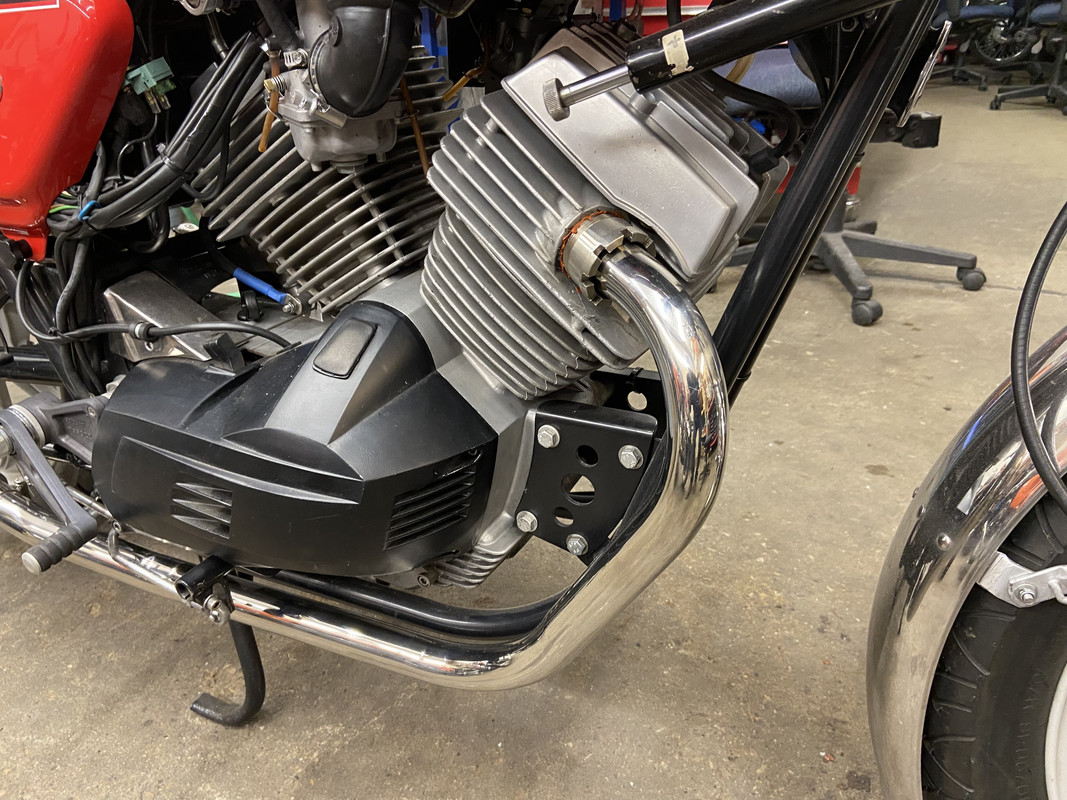

I have a pair of 'Norton Goldstar' (their description) amplifiers, sorry silencers on my Norton and they seem well made with no dodgy welding or polishing evident. Had to make up new hanger brackets as they fit the mounting bosses at different centre distances than Norton have though. Apart from being a bit anti social I like them.9/10
The Armours 'Morini headers' I have look well made, but when new you have a choice of either a perfect fit at the heads but balance pipe doesn't line up by around 4-5mm, or vice versa. When 'assembled', I then had to 'persuade' the silencers to exit at the same height each side. 5/10 could easily be 9/10 if they tried just a little bit harder. This is a common complaint regarding Armours pipes on many other makes too. Makes you think they used to supply Meriden with headers as Triumphs were well known for wonky exhausts back in the day!

I have an Armours exhaust system on my 500 Sei-V. It fits well and looks good but is too damn LOUD!
Are there alternative silencers. maybe Keihan, which would be much quieter? I did think of trying to fit mutes but was told this was a bad idea - has anybody tried them? I'm not bothered about performance, the bike is more than fast enough for me but the constant loud roar just spoils an otherwise excellent ride. Any suggestions welcome.
