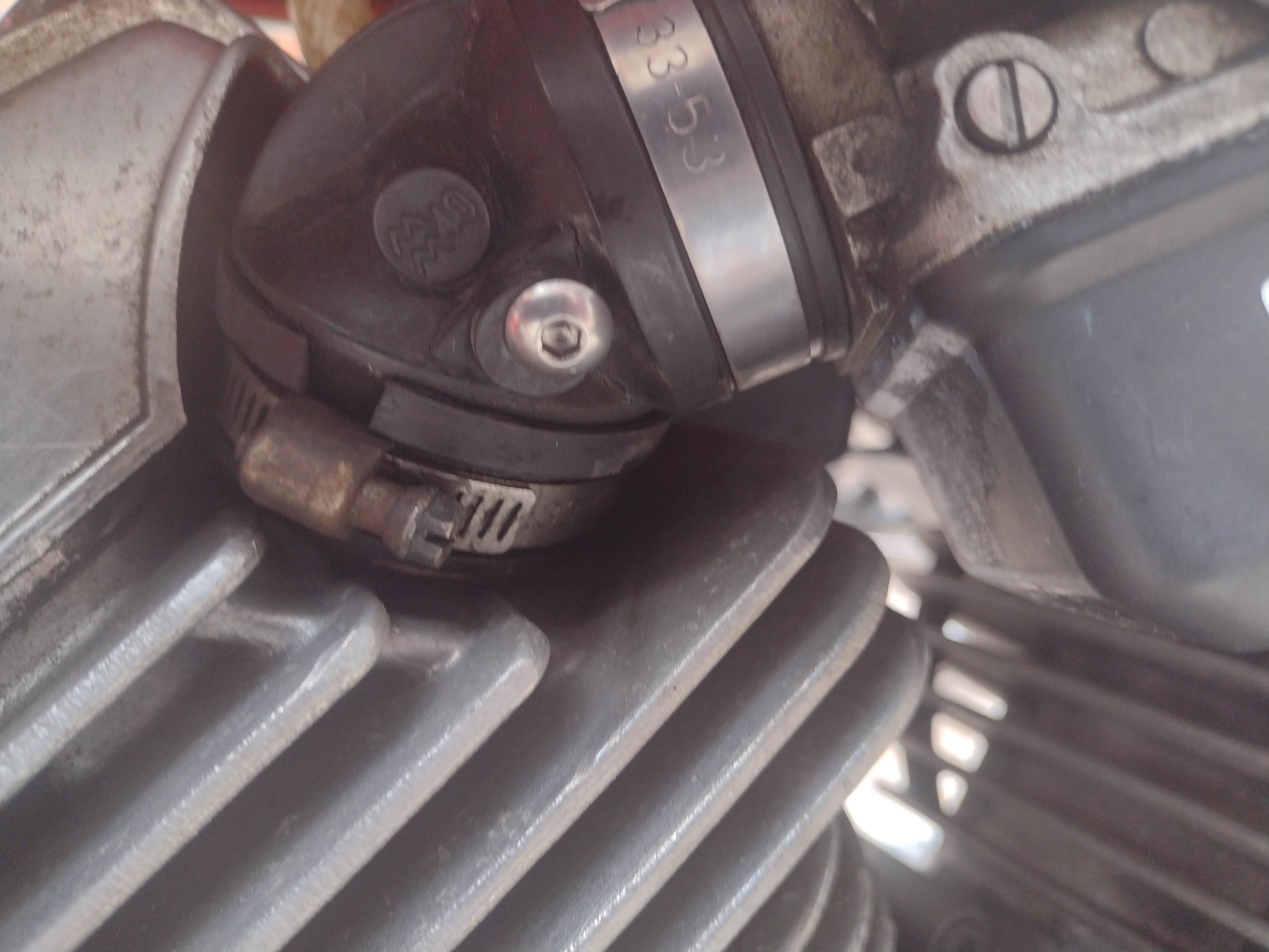

Being the bodger that I am, I just drilled holes in mine on the 375 that uses PHBH carbs with no balance pipe. Sealed with a stainless steel dome head socket head screw. M5 if I remember correctly - I can check. The OEM rubbers had natty stepped 'plugs' but I assume these are unobtainium.
The drill needs to be small enough that the screw actually has to be screwed in rather than just pushed (they sort of cut their own thread). Surgery performed too long ago to remember the exact size drill I used.
Never had any problem with them working loose or leaking air and the adapters that came with my (modern) Carbtune work well in the 'holes' too.
Others may have employed a more elegant solution.

A picture is worth 1000 words. Definitely M5 - drill hole smaller than you would for tapping in to metal though.
I find 'close but no cigar' by ear and feel. Good enough for sure, but when you get those carbtune columns dipping together perfectly given a whiff of throttle I reckon you can feel the difference on the road.
You can probably drill more accurately in to the centre of the 'boss' than I did. I'm not a great one for immediate appearance over underlying form ;)
Posts: 1554
Re: Connecting Carbtune Manometer to Inlet Manifold

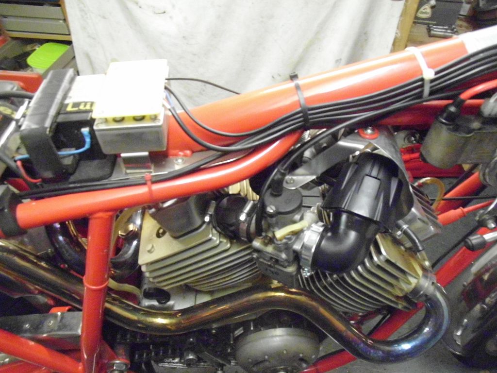

Aha. That photo reveals some incipient cracking of the rubber. Almost certainly due to having no air filter box, S&B cone filters and big zip ties to take the strain. One day I will get some proper high tech supports made. Then I dare say this set of rubbers will "see me out" ;)

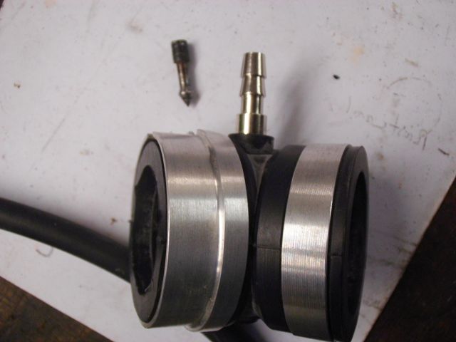

Posts: 927
I´ve done that the same way as 72 degrees and it worked without any problems for years. Just make sure that the screw does not enter in the manifold canal. If I rememer it well, I´ve added an O-ring underneath the head of a simple allen screw.
There are some special "plugs" to seal the hole in the rubber. But I prefered the solucion with the screw :wink:
The cracks in the manifolds for not fixing the carbs when not using the normal air box normaly begin in the fold where it is put on the cylinder head. They advance from inside to outside, so you cannot see it from the outside by the right time. Normaly you notice it because it´s not posiblle to achieve a correct idle. Then it´s time to have a look at the iside of the manifold.
Using a tube between the underpresure points between the carbs/manifolds can simpify to adjust idling.

cheers Paul
Years ago one guy of the german comunity has made some of them. I regret having bought only one pair of them :roll: Especially the one for the cilinder conection is very useful.
I´ve had a lot of broken 501 manifolds for years (only the 501 ones, no problems with 350), with a 350 airbox. I guess because the used snorkels from a 500 fitting on the PHBH 28 produced a certain tension on that manifolds. It´s very important not to overtight the clamps!
Dulcinea wears Polini filters and I´ve cought them with stainless steel stripes > manifolds last a lot longer than on Rocinante with the 350 air box. If you don´t catch the carbs using pot filters, you´ll be in trouble for sure!
