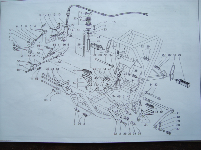

Hi, see attachment
- 501,Camel XE.JPG (141.06 KiB) Viewed 14429 times

It looks from the Camel diagram as if the left hand change is integral to the frame. Is there any way of leftifying a 500 sport with some type of kit that bolts on?

As you've seen here the Camel and Kanguro are Left footers as standard. They have a crossover tube welded into the frame, close to where the centre stand pivot tube is. As far as I know there are no ready made kits for sale but there were some done either by the factory for various markets/models. The custom variants for instance had a crossover tube bolted below the front engine plates. This was convenient for those bikes as the footrests are positioned well forward.
I think your only option will be to fabricate something to suit your own requirements. I imagine it wouldn't be too difficult to hang something from the area of the lower rear engine mount on your bike?

Hi, the twin shock 500 Camels have a linkage system on both sides using a cross over shaft/bushed frame tube near the centre stand pivot.
The later 501 Camel/350 Kanguro square frame arrangement is much simpler with less parts
Also see https://www.morini-riders-club.com/foru ... php?t=4928
