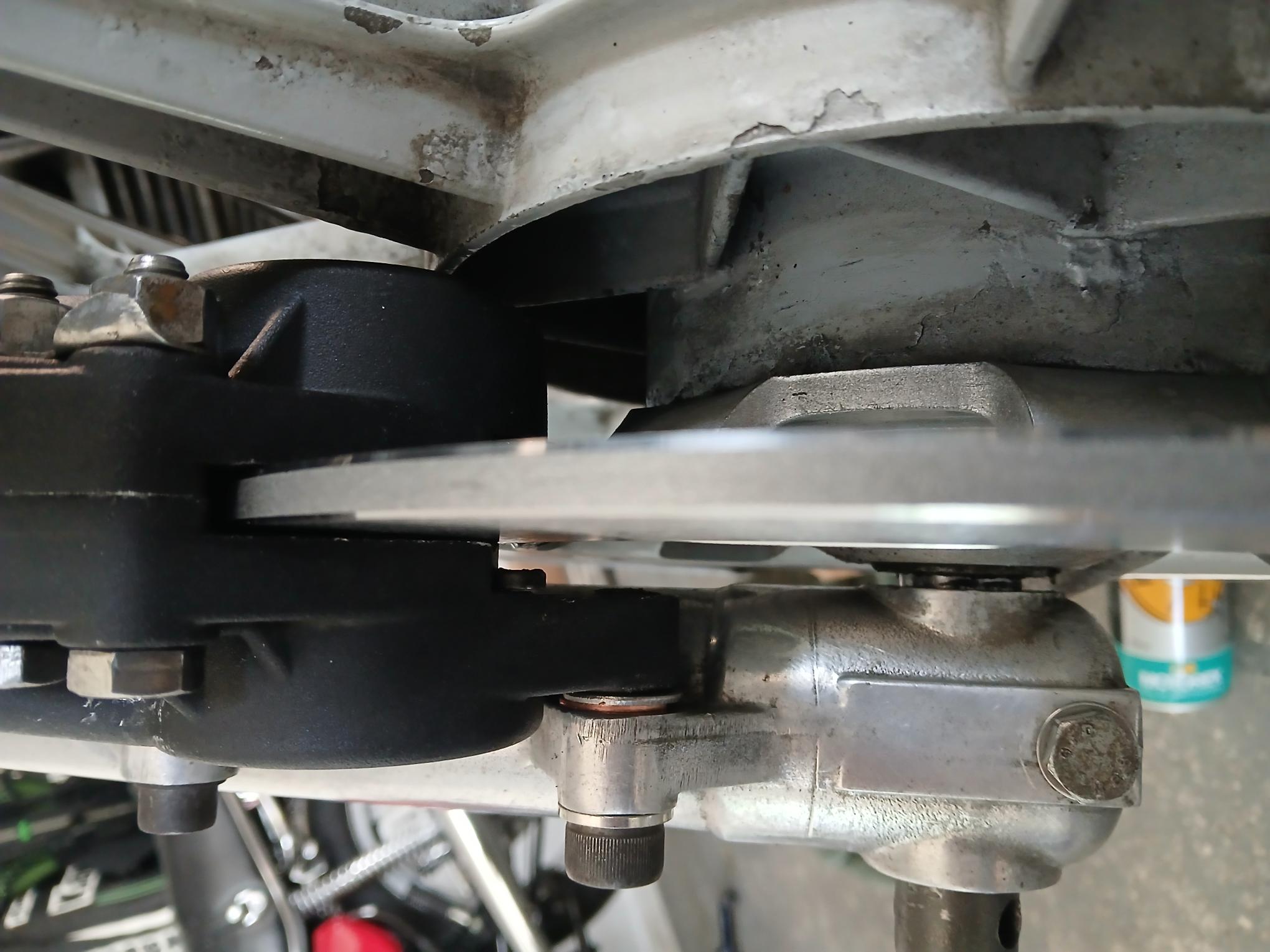

Re: Brake discs - FRUSTRATING!
Well.
The only thing I really didn't like about the bike was the brakes.
Unpleasant pulsing on the front and gabbing/overheating on the back.
I thought it odd that an expensive renovation hadn't addressed either.
The rear disc was absolutely shot with deep grooves and the pads were in a shocking state. New pads and a skimmed disc have improved things very much cosmetically but it's not as powerful as it should be - I am wondering that they've taken so much metal off to get rid of the scroring the disc isn't thick enough now? It measures 5mm?
Front discs skimmed down to 6.3mm and they look great and the calipers are rebuilt too. BUT, having gone for a spin around the block the pulsing is EXACTLY the same as it was before so I'm at loss really. Any ideas?

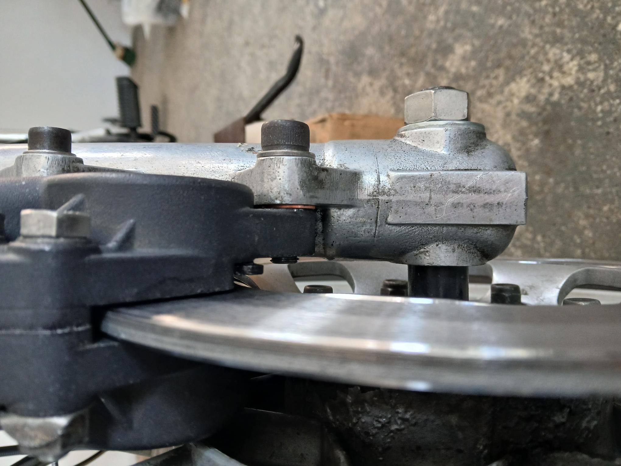

Happy days as I can report the pulsing braking has been completely cured.
In the end what sorted it was using some thin washers to shim the gap on the lower mounting point between the calipers and the fork legs. You can see the copper washers in there.
I'm not sure whether there are actually supposed to be any shims/washers/spacers in there but it certainly seems to have solved the problem.
