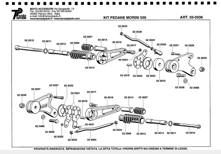

Re: Swop gear change side 500 Morini.
Screenshot 2023-11-10 at 10-37-35 Morini 500.png (215.21 KiB) Viewed 63 times
You could fit rearsets?

Post by caddy4037 »
Thanks to " it must be a ".
The bike came with those rear sets and the rods and fittings, I've taken them off.
Photos from the post that you referenced are helpful thank you.
