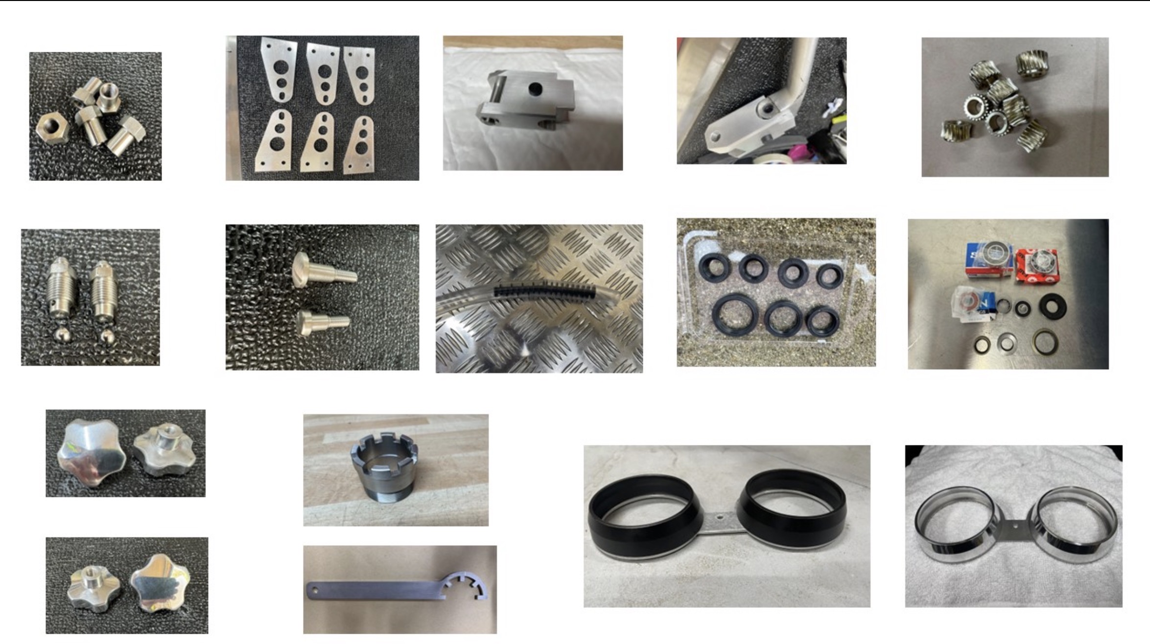

Stempy
Posts: 209
Joined: 07 Jul 2020 08:23
Location: Grimsby
Re: 78’ 500 clutch plates
Post by Stempy »
Posted to Australia a few times ,Olly makes a few bits for Morinis see below
Posts: 405
Joined: 12 Jun 2022 18:49
Location: Warwickshire U.K.
Post by Morini Jen »
Brilliant! :D
That's what you want...
I have bought the hexagon head clutch nuts and an exhaust ring spanner from Olly and the quality is absolutely superb.
