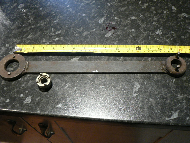

I found it quite tricky even to get this nut up to 5mkg, maybe it's the tools I have (spoken like a true bad workman!). The holding tool and "socket" are:

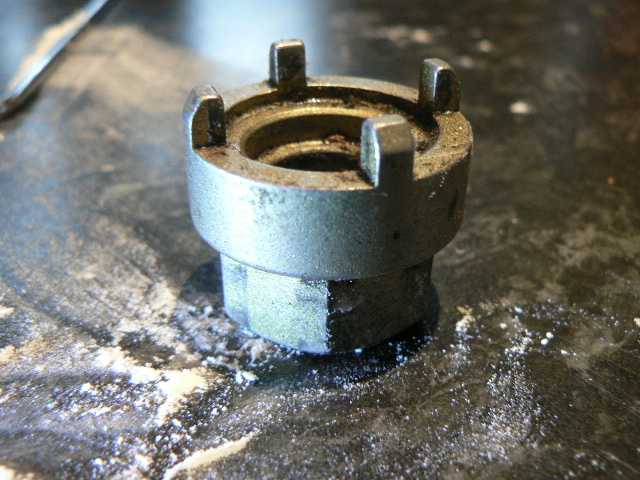

and the business end of the socket is like this:
Both are a good fit, but both have their problems. The handle on the holding tool is short and really needs a length of pipe to extend it a bit. It then needs two hands to keep it securely engaged under pressure. The socket is quite long and since it can only engage to the depth of the nut, putting any strain on the torque wrench tends to pull it off the nut, so that needs two hands as well. I only have two hands in total!
I ended up clamping a length of pipe in the vice, with wood blocks spacing it so it went across the bench at an angle. I positioned the engine so that the holding tool engaged with the pipe. I then had two hands for the torque wrench, one to hold it engaged with the nut and one to heave on it. It did slip off a couple of times before I managed it and I really don't think I'd have got it up to 13 mkg. It might be easier with two pairs of hands and I'll try that next time. It may also be easier with a brand new nut, and I have one of those on order. I guess it might also be easier with the engine back in the frame, which is where it is now. I shall report back on how it goes!
Joe.

Yes, your holding tool is about right but too short, mine is about 18" long (also has the holding tool for the camshaft sprocket on the other end) and with the engine in the engine work cradle/stand then you can also either use the bench or a peg through the cradle to resist turning. The socket you have for the nut looks nothing like the one I have, is it made from a soft material as the one I have is heat treated and hardened as with any spanner/socket. It has four pegs, 5mm long that locate into the nut and a 24mm hexagon that protrudes through the holding tool just sufficiently to get a socket onto it. This arrangement gives the holding tool a better location as everything is close to the nut and the socket acts as a spigot. I still have some original hexagon nylocs for this location.

harrymuffin - the special socket I have is good quality, some kind of hardened steel and seems accurately made. The only problem is that it really needs two hands to use it because you are applying the torque too far out from the nut - I'm sure you know what I mean. I just received the new nut in the post, so I will strip the primary again and fit that. I'll try to get someone to help by looking after the holding tool.

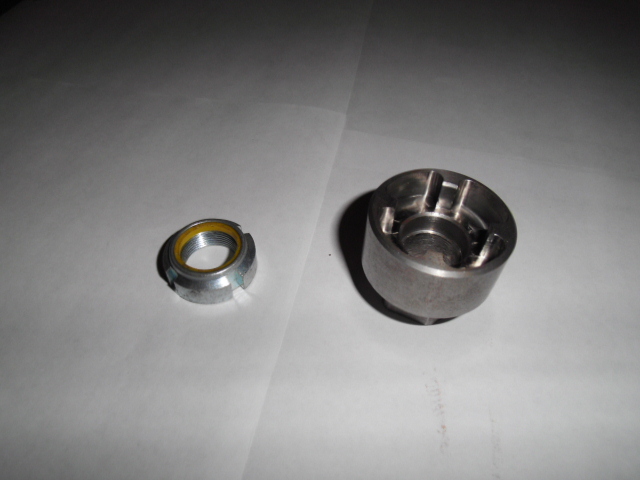

I asked in the german forum and it looks like 10Kgm with a bit of loctite semifastenglue is what experienced people do aply here.
this is my tool norbert
