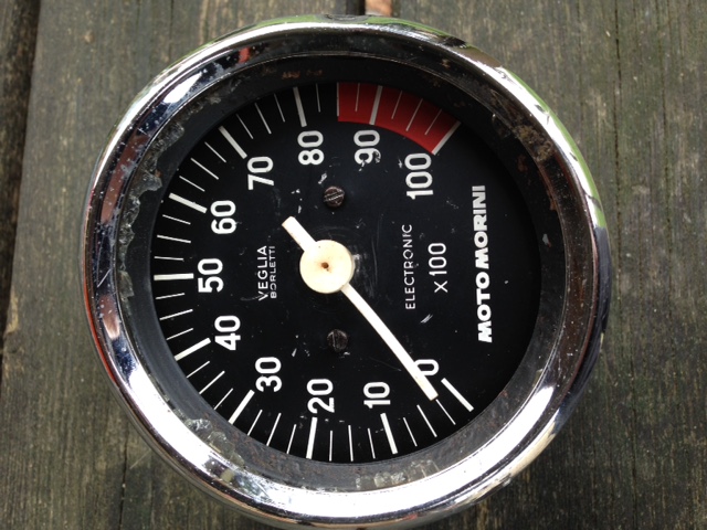

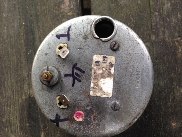

Re: Veglia speedo repair
Can't see how to attach a photo to a PM, so I attach here - sorry if it's a hijack.
Veglia electronic tacho, broken glass but works (calibration not checked).
Tacho verso.JPG (131.6 KiB) Viewed 12147 times
