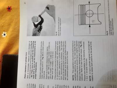

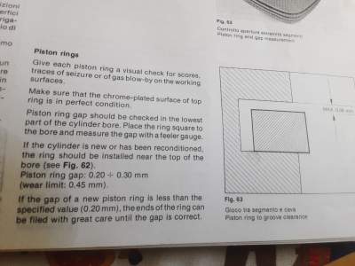

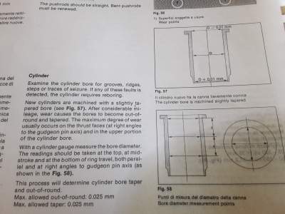

Re: 1980 500W first time project introduction
Hi Fiona,
Just to add to the confusion, my Blue Book states piston clearance of 0.050 to 0.055mm at centre of ring travel. Max wear is 0.10mm. The bore should be tapered with +0.011mm at the bottom and -0.01mm at the top.
Pistons should be 0.2, 0.4 and 0.6mm oversize.
I'll photograph the relevant pages and attach later.
*Edit pictures added. Hopefully they are readable as reduced in size.
Thanks mickey moto, a great help. I should have personally checked the manuals again - that 0.05-0.055mm translates to around 2 thousandth inch; which is what the old engineer works in from doing old British bikes. Harglo manual still confuses and lists piston clearance at gudgeon pin height as double, 0.1-0.12mm, or 4 thousandth inch. That's where I got a 2 and 4 from for clearance, mea culpa big time but relieved that I double checked before ordering.
This and seeing in Harglo the oversize pistons are for bore sizes + 0.2 or +0.4mm makes much more sense. I'm mainly the parts finder for this project, and passing on questions as best I can. I appreciate the advice and the patience of folk on this forum
