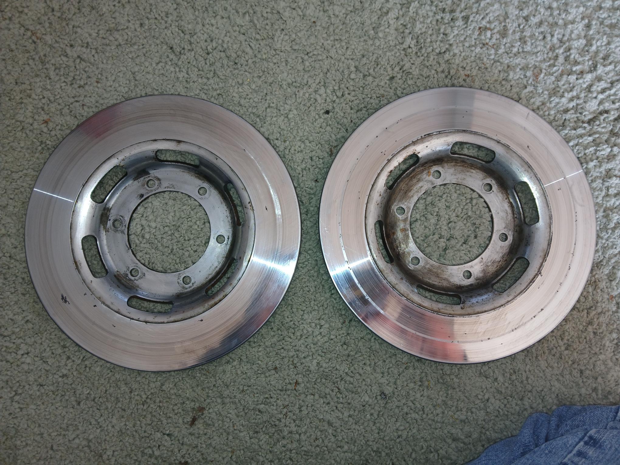

I've just been looking through some invoices which came with the bike and one of the entries is "investigate front brake pulsing" but it doesn't look from subsequent invoices that it was sorted, unfortunately which is why the discs are knackered i suppose

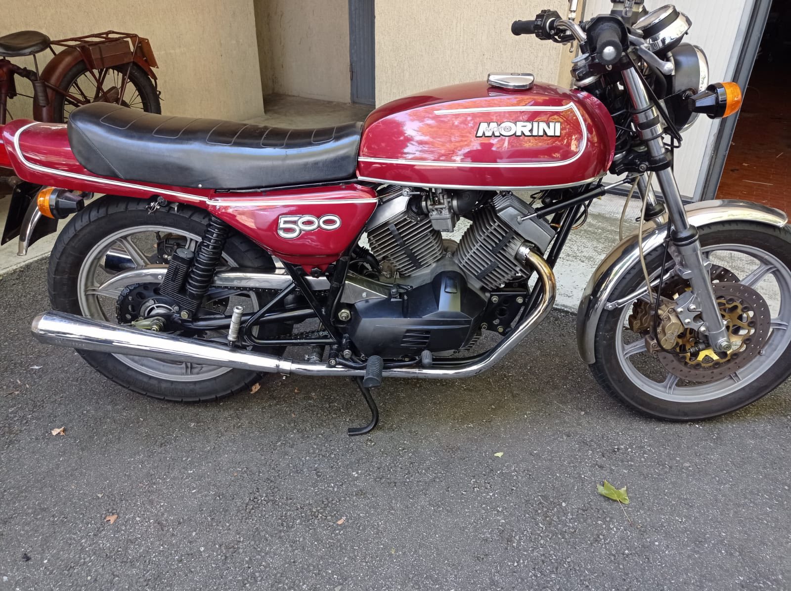

Interesting front brake conversion spotted on facebook
moto morini 500 brakes.jpg (410.47 KiB) Viewed 2124 times
Posts: 927
Re: 500 Strada front brakes.........
Changing pads and brakingfluid of Roci these days I've found one outer piston that did not regress totaly. So I changed the caliper for a reserve one that I overhauled years ago. But one pad did not move freely until I changed the original 3,2mm splints for 2,9 mm ones.
TimClarke
Posts: 106
Joined: 16 Feb 2025 14:22
Location: Great Missenden
Post by TimClarke »
Dickyboy wrote: 19 May 2025 07:46 Interesting front brake conversion spotted on facebook
Excellent!
