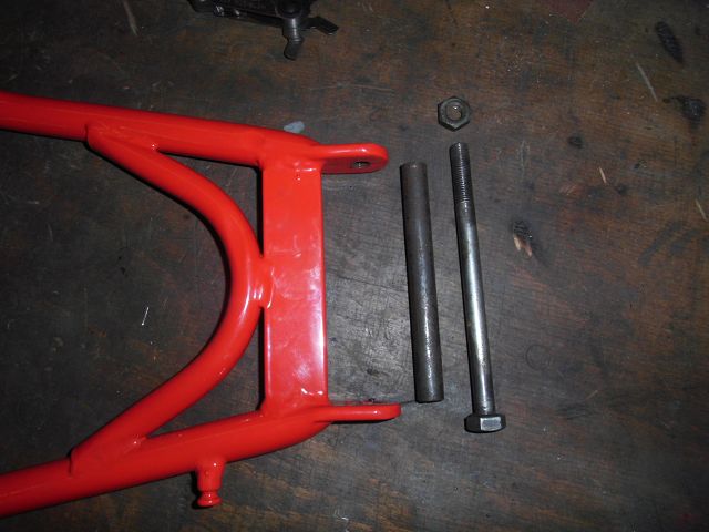

Well it finally came off on Saturday morning but not before I'd made a real pigs ear of it.
I drilled down through the bolt for about 30mm and then realised the drill was skewed and had penetrated the tube sidewall. That left nothing for it but to cut the tubes an clear out the frame holes. I also had to remove the stand stop with the rubber bumper pads but they are easily fixed and re-welded into it's position.
I'm now trying to source the necessary seamless tube profiles at 18mm OD and 14mm OD!! Scarce.! like hens teeth..!! Seemingly even the latest order that NLM received had to be returned to the supplier as they had supplied seemed tubes which don't allow either the inner tube or bolt to travel through the outer tube as a result of the internal seams from rolled welded strip steel.
I've read the alternative suggestions above and whilst they are all logical my thoughts are to use the original remaining piece of tube that I salvaged and once the bolt is removed clean them up and re-weld them back in situ as stubs rather a full cross frame tube. Then use an original sized bolt all the way through. I'm confident this would be more than adequate and would prevent the build up of future corrosion and much easier to service.

Continuing this thread a little further. Everything was cleaned up ready for new tubes. I obtained the 14mm seamless tube without too much trouble, the 18mm was a compromise.
In the end I bought 18mm rolled welded strip tube and then just eased a drill through the remove the seam. Tubes were cut to 120mm and then dressed back to 118 which is the actual space size between the stand fixing lugs. Tacked in with Mig welder and then the frame was taken for powder coating. Awaiting it's return now!
