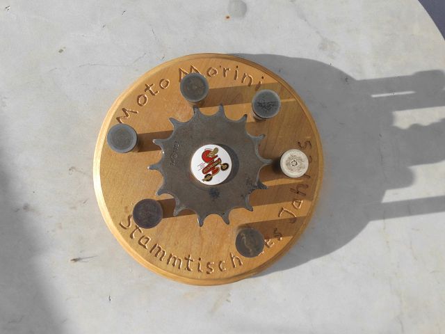

So you meen the cups or the rods?
Here you can see some worn cups with pitting that I used for a trophy for the "Stammtisch of the year" (Stammtisch means the table of the tribe) given to the Stammtisch that made the most km to come to the meeting. I once had a broken rod on a trip. Suddenly one cilinder did not work. The aluminium rod was broken just where it enters to the lower steel part. The rod fell aside and did not make any noise at all, just the rear pot refused to work anymore. Went on to a meeting 60 km with the front one and then found out the reason. There was some kind of Voodo happening. When it happened I stopped to do the usual things (looking for sparks and if the gasoline enters to the carbs). Both things were ok, the motor started on one cilinder without problems. And then I found this little broken bike dirctly underneath the motor in the dirt!
You can imagine that? I was realy disturbed! I decided that there must be something wrong with the valves, took of the gasoline from the rear carburator and went on 60 km to the meeting, where I found out the reason of all. The little pendant I still keep together with my minature Morinis
Later I remembered that for some days before I have noticed a new sound like a very a high but not loud plingelingeling, without any idea what it could be. The truth is that I allways wonder how diferent theses motors may sound

Cups.norbert wrote:So you meen the cups or the rods?

I think usualy there may be some pitting where the cup is in contact with the cam. It´s the first time I hear of a broken cup (well, there´s always a first time). Normaly you have a light mark in form of a ring, I guess because the cups are turning around. But I don´t see a reason why even stronger pitting should afect directly the shells of the big end. If its realy broken, then there must pass some parts the oil"filter" to come to the shells.

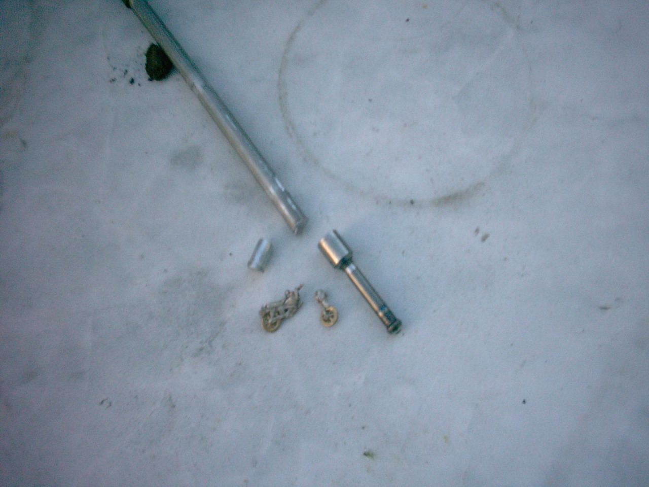

The part that has failed is the walls of the follower, where they fit inside the crankcase, all four were a very sloppy fit, but one had broken up completely on the walls of the part where the pushrod sits, I will need to get the crankcase wear lined back to original spec, I think that was the first failure at Cadwell then bits of metal were flying about which led to the big end going, it will be interesting to see what the damage to the crank is, but that will have to wait.

The motor is now apart, the very sloppy cam followers made us think that it would be necessary to have the crankcases sleeved where the followers run, however thanks to EV guru who supplied a good set of followers, it appears that the wear was entirely on the followers, the newer ones fit well. Possibly they were undersize to start with, I have no way of knowing.
The engine must have been Excalibur since it has surprisingly a J cam, I say surprisingly since this bike has always been livelier than my other 501 engined bike, leading me to think that it had a hotter cam, but it's not that. I would love to build it with an L5 if anyone has one they could be talked into parting with.
The big end is shot, but should be recoverable, the gudgeon pins are showing evidence of moving within the pistons. I'm not sure whether to go with the original timing side plain bearing, or go for a roller conversion, what do you folk think?
The bike does have a fairly hard life, regularly getting thrashed on a racetrack in "parades". Incidentally, my engine builder pal was horrified to learn that I was using Halfords semi synthetic oil, which he called some very uncomplimentary names, I did change it every few hundred miles, given the hard life it gets, but he feels that I would be better off with Castrol R, (He is a Ducati race engine man) However, I don't really want, or feel that I should need to go down that road. NLM swear by Motul semi synthetic, again, opinions welcomed.
