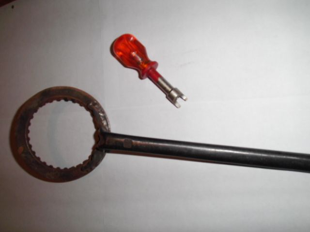

at the moment I'm having a small problem with the clutch, slipping at WOT.
solution seems easy enough, check for wear on clutch-plates or for fouling/oil of clutch-plates. this seems easy enough.
the hard part is to get the six bronze adapter screws out of the clutch. is there special tool to do so or some kind of trick?.
regards Anne

I cut a small piece of flat steel to give two pins with a cutaway so it engages with the top of the clutch nuts, or you could do similar with a box spanner of suitable small diameter or cut a slot out of an old screwdriver. I can carry the metal piece though in my toolkit.
The nuts themselves might not readily unscrew, or the studs can turn with the nut if they have come loose.Lets hope that does not happen.
Clutch plates may be worn or contaminated with oil, you may see a small amount of oil at the bottom of the clutch case if it is leaking. Sometimes the cups that the springs fit into can stretch slightly so that the spring pressure is effectively reduced.The cups can be nipped up gently in a vice if they are stretched but they must still fit through the outer cover.
Let us know if you get stuck.

i am not aware of a special tool , i ground a old 3/8 socket to fit the slot.
having said that , they can be a pain to remove the first time .
add copper grease when refitting them prevent the same happening again.

Be careful if the nuts don´t come loose! You can try heating them up and give them some time bathed with WD40 or something like that. Before you apply too much force and loosen the studs, I would prefer to destroy/cut the collar of the cups, so you can take off the presure plate and the rest of the plates. Then it´s easier to work on the nuts. There are studs hexagonales and round ones. If you are luck you have hexagonales and can hold them with a box wrench when trying to take off the nuts. If the studs become loose you´ll have another issue. It´s much easier and cheaper to find some new cups than a center barrel in good conditions!
If you get scared to loose the studs: give a good bath of brake cleaner spray to the plates, sometimes that can help without dismantling the clutch.
The nuts shall be mounted always with copper grease and it´s not necessary to put them on with strength, they won´t come loose!

made a small adapter like the screwdriver in Norbert's post and then the nuts came of quite easily, after some ....correctly applied force.
all plates were more or less contaminated with oil so left them to soak in thinner/cleaner for some time, polished and cleaned them
refitted in reverse order
testride tomorrow morning, will keep you informed
