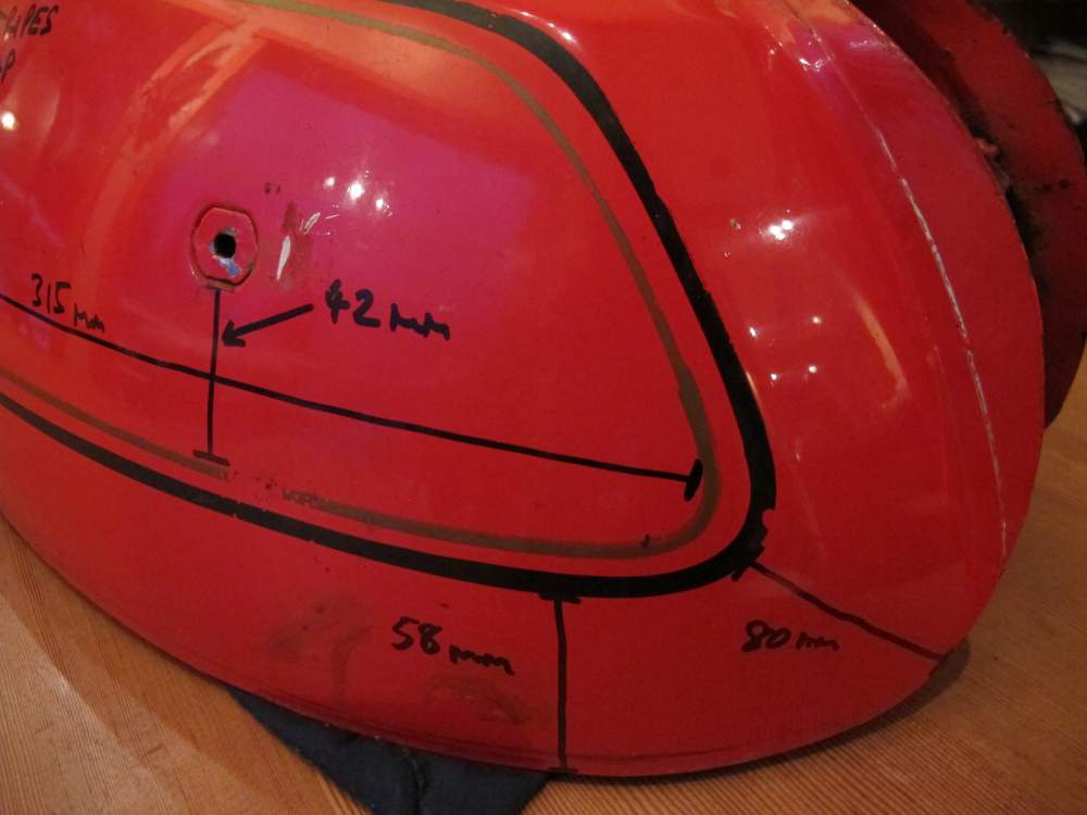

I also measured and photographed the location of all the pin stripes.
I have a number of different photo's like this one showing the exact location and dimensions of the striping. If anyone would find these photos useful please feel free to sent me a PM.
