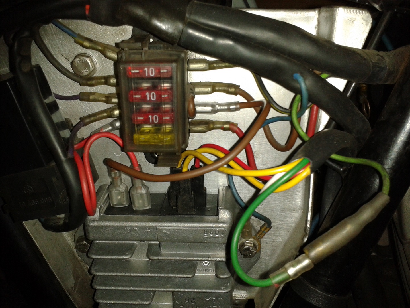

I should add that PLEASE don't use the horrible crimp connectors that come with red, blue and yellow 'insulation' on them! With the possible exception of 'scotch bloc' crimp on connectors, nothing looks more horrible/bodged on a bike than these.
Avoid soldered joints - they are less reliable than properly crimped joints.
As other posters have said, VWP and Auto Electrical do proper connectors that are neat and tidy. While you are at it, you need to decide whether to copy the original loom piece for piece with all of its excess of wire and connectors, or go for a sensibly designed new loom that eliminates lots of the excess. The former method is the easiest, the second (I believe anyway) the better way.
As an example, the 1978 31/2 originally had over 4 metres of wire and I believe 9 sets of switches/connections between battery and headlight. On mine, I reduced this to the same 3 switches (ignition, lights on/off, dip/main), 1.5m cable and just 4 connections.
I hopefully have added a pic of what it looks like under the rhs side panel now (I was alarmed to realise that this wiring is now over 20 years old!)
All depends on how comfortable you feel with doing wiring.

- wiring pic.jpg (441.93 KiB) Viewed 17784 times

Couldn't agree more, it is more like an electrical substation that a amateur electrician would cobble up and I too reduced the wiring down to half a dozen wires with a single 12v lead to the front of the bike rather than to and froing, Morini must have had shares in the firm who made all the wires and fittings.
