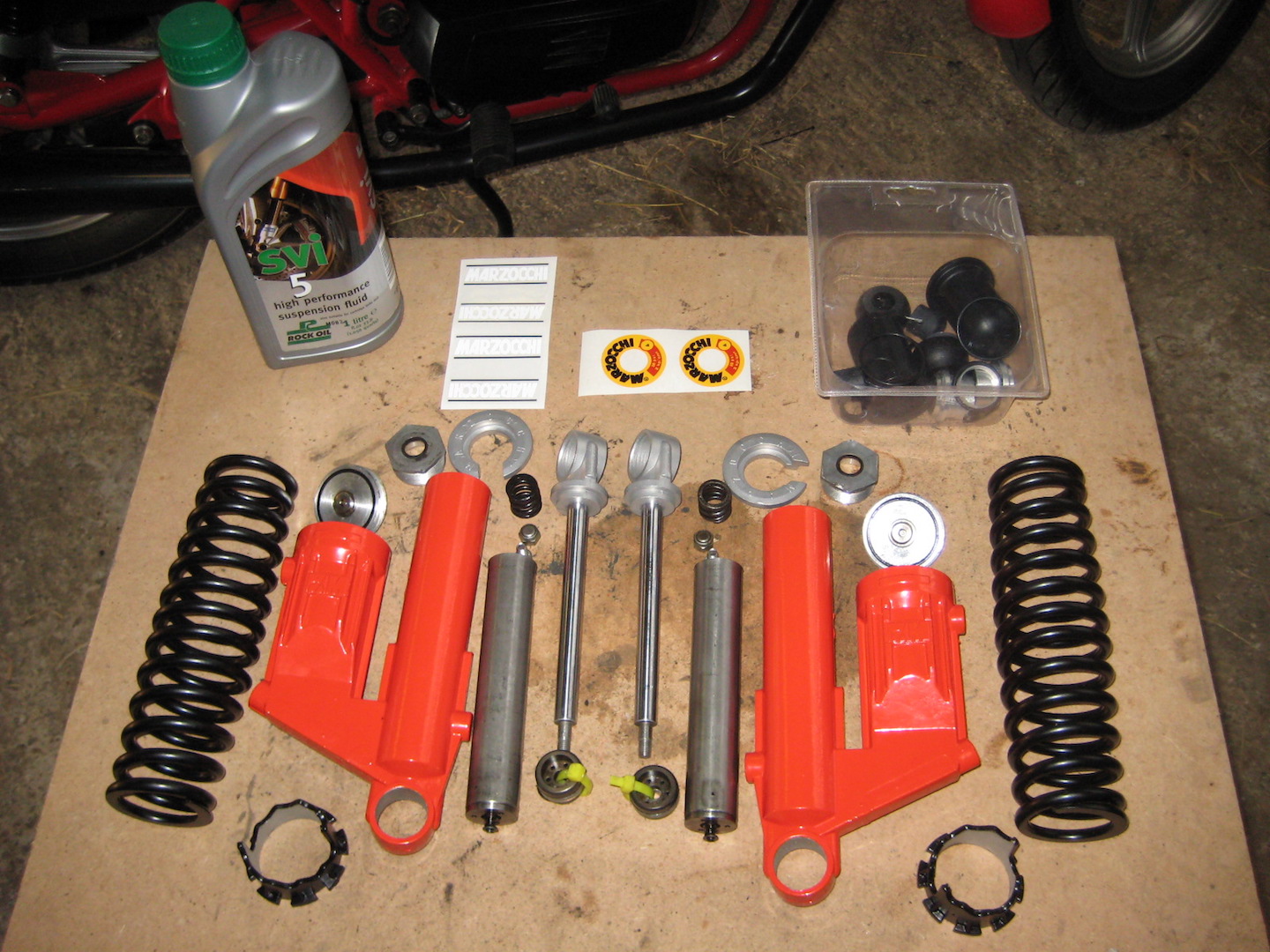

A couple or years ago I rebuilt 2 pairs of Marzocchi Strada shocks, the ones with the piggy back air/oil reservoir.
Some of this info may be of help…
I had the springs and bodies blasted and powder coated.
Rebuild kits were available for a variety of Marzocchi shocks but since the company was closed down and the motorcycle suspension business was bought by an Italian components manufacturer I’m not sure kits are being made any longer.
I bought my AG Strada rebuild kits from here:
http://marzocchimoto.blogspot.co.uk/p/a ... t-now.html
But the site says kits are no longer available.
This Italian site lists lots of kits but no indication of availability:
http://www.suspensionzana.com/index.php ... Itemid=114
According to the manual for the Strada, the fluid to use is “Special Oil Marzocchi SAE 5”. I used SAE 5 Fork oil.
