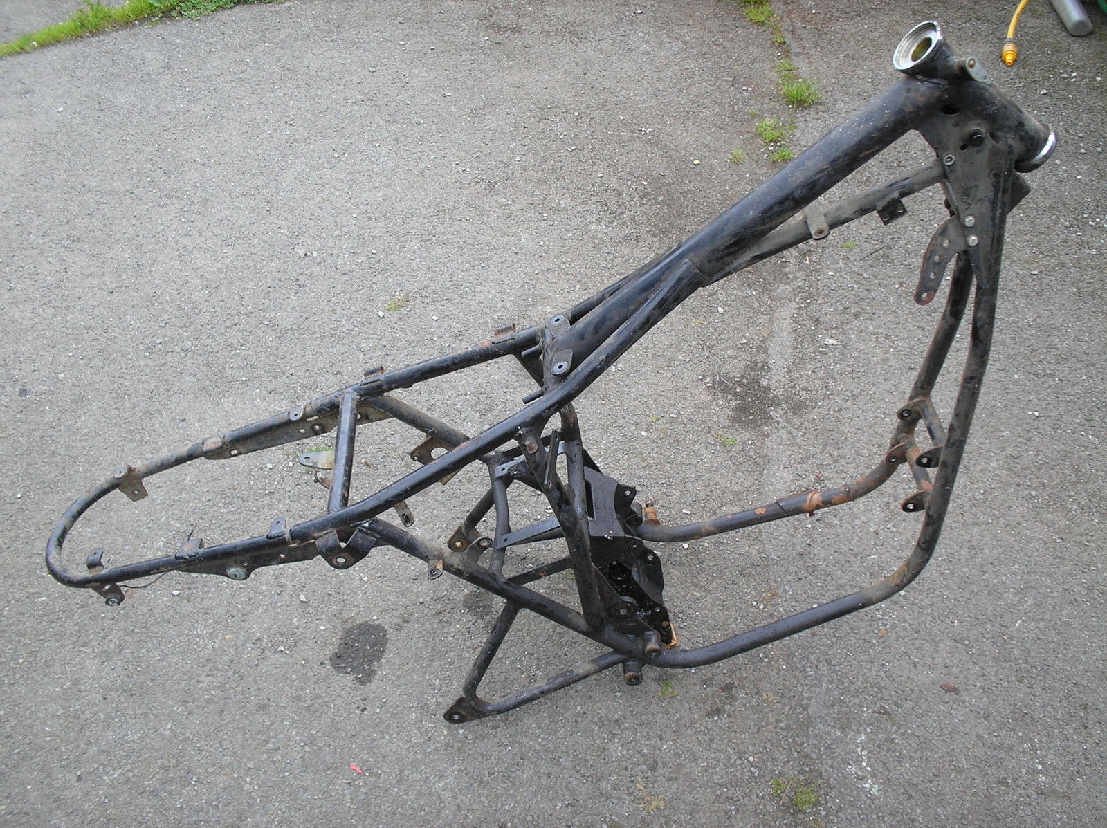

Re: Frame question
hi
I cant work out how to attach pictures to a PM, but have managed to upload them to the forum.

Re: Frame question
As this is the frame you wish to buy? It should be easy to compare the details with the Q reg frame of your bike.
Have fun and take care, Ian
