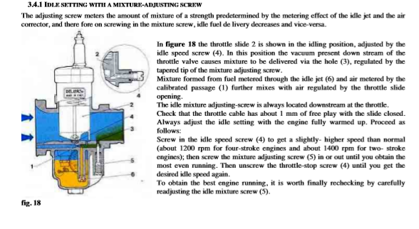

Extract from tuning guide which you can purchase here:
https://www.dellorto.co.uk/shop/tuning- ... guide-1-1/

In to weaken and out to enrichen, I believe.

With this little crew you can fix the amount of the idle-mixture, not the relation air-fuel. Therefore you have to change the idle jet.

Not an air screw.
