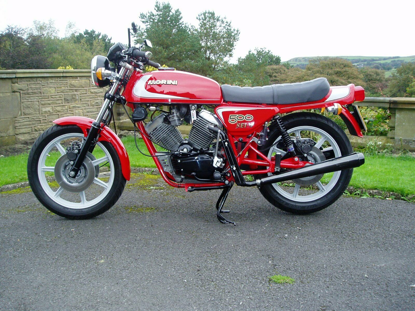

I have recently acquired a 500 SEI Sport, and whilst I am doing the necessary servicing, I thought I'd address the problem of the self returning side stand.
I've almost dropped it twice because of this!
Does anyone know of any sort of bolt on replacement, not keen on the idea of having to undertake any welding on this bike (please see the photo attached).

If the 500 is the same as my 350 K2 was, the pivot bolt for the sidestand has a protrusion, that once cut off allows the stand to stay down.

As said above, the older models had a standard bolt as a pivot. No need to cut the original-it will be a priceless artefact by next weekend. So save on hacksaw blades and cutting discs. Very smart bike by the way and the best of the 500 series too.

Picture of my sidestand, 500 Sport 1980. Stays out with enough force, and stays secure along frame when folded in.
Spring is original, but i'm not using part no. 15. Rubber bumper is homemade. Top fastening point for spring has been repaired.
