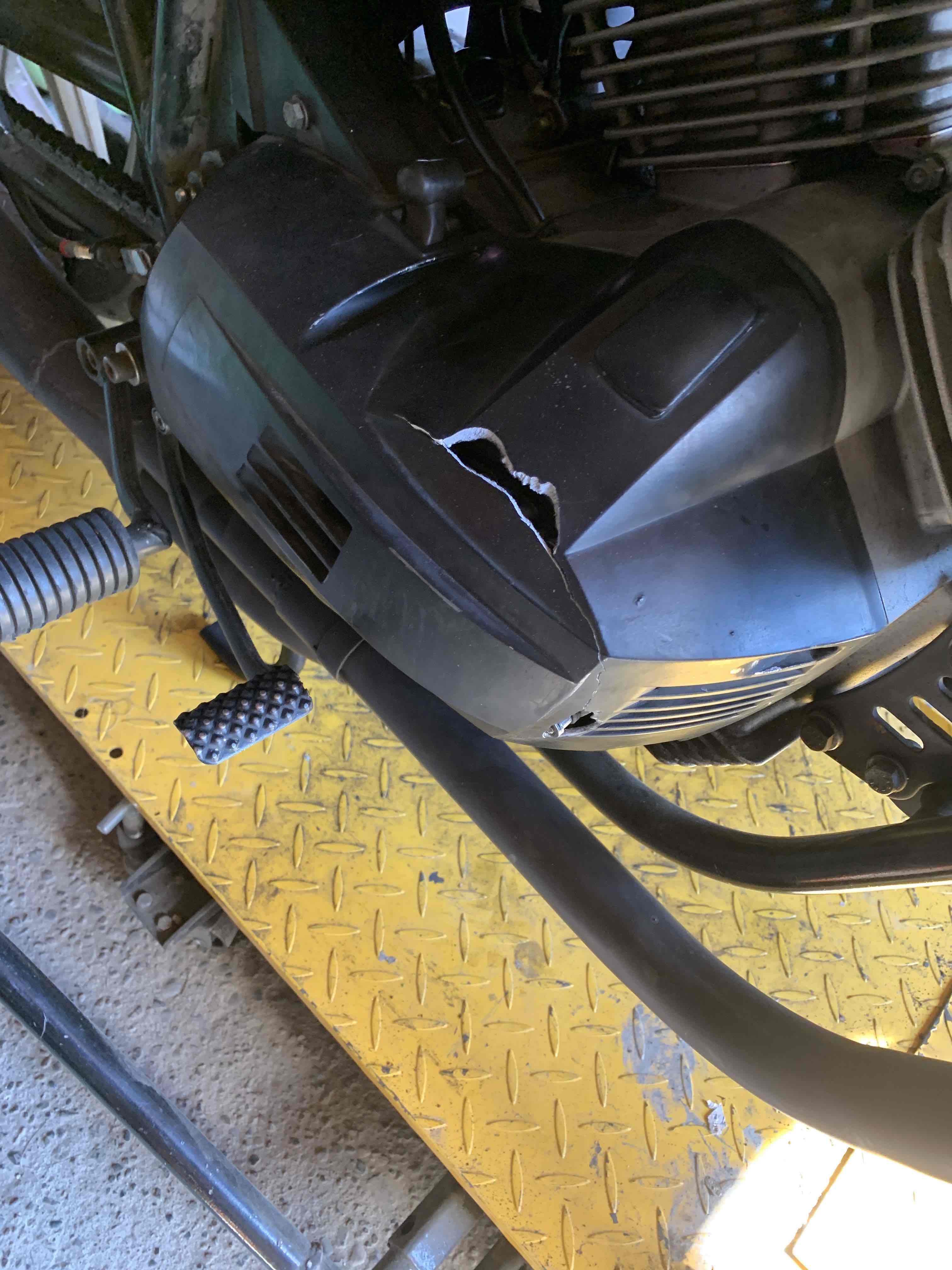

Hi. all. I bought a 500 sport last summer and love it. Just had an issue im hope that some one out there can help with. lost the chain on the starter and it cracked the RH cover part #11.02.21 and striped the sprocket assembly Part #11.03.24
I completely took the starter and the assembly out so i can ride it with just the kick but would love to get the electric start going and to have a cover with no holes. Any one know where i can get a new RH cover?

That looks horrible. Was the chain slack or did a link come off? Let’s hope someone has a spare case, or you will have to check Medina Italia, eBay de where there are some for €€. At least the crankcase was not damaged.
Whether or not it could be repaired by weld or aluminium epoxy I don’t know.

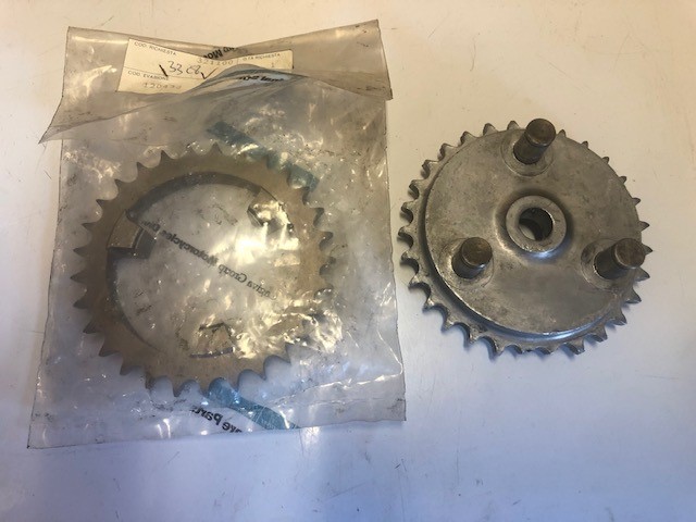

I have decided to weld repair the side case. I also need the stater sprocket, I did order the one listed on the MDINA site 12.04.32 but unfortunately this is not the correct one.
Would anyone know the correct part number for the sprocket assembly with the 3 shafts for the starter shoes and if they are still available.
Keefe
Keefe
- Sprocket.jpg (62.88 KiB) Viewed 12149 times

Yes, it does help if you have the parts listings for your model, many of which are in the members area of the club website.
The part number for the pre cush drive starter sprocket is 11.03.24
Herdan appear to have them in stock.
Your missing teeth could be welded up and re-cut.

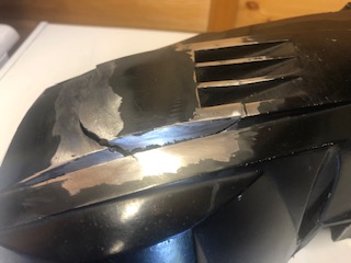

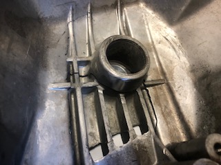

I’ll post an update next week, this is the current damage to the casing.
I am going to try Paul’s suggestion and added weld to the missing teeth and recut as the sprocket appears to be an alloy.

The 501 camel XE (last series) and Kanguru X3, and excalibur 350 too? (built under Cagiva ownership) had the sprocket with rubbers - cush drive if you like.
So kmac the sprocket you bought was for that assembly.

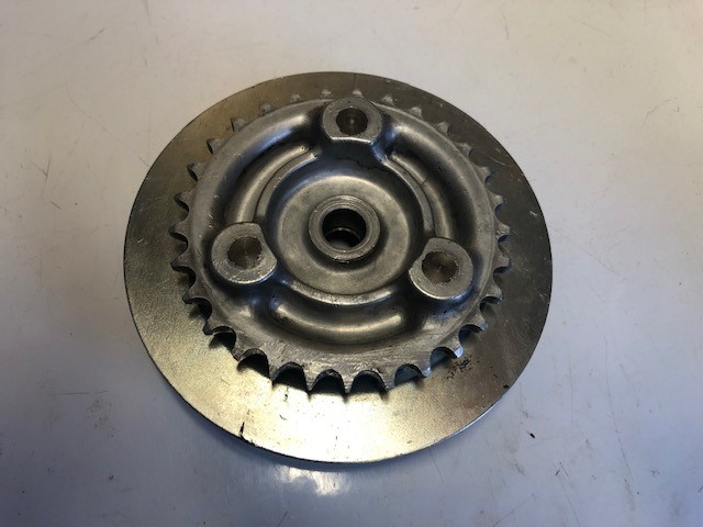

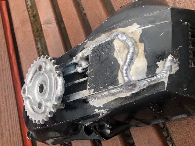

Final update, I repaired the starter sprocket as suggested by Paul, building up the broken teeth with weld and re-cutting. Welded the side casing inside and out, painted and back on the bike. Thank you all for the advice.
Keefe
Keefe
