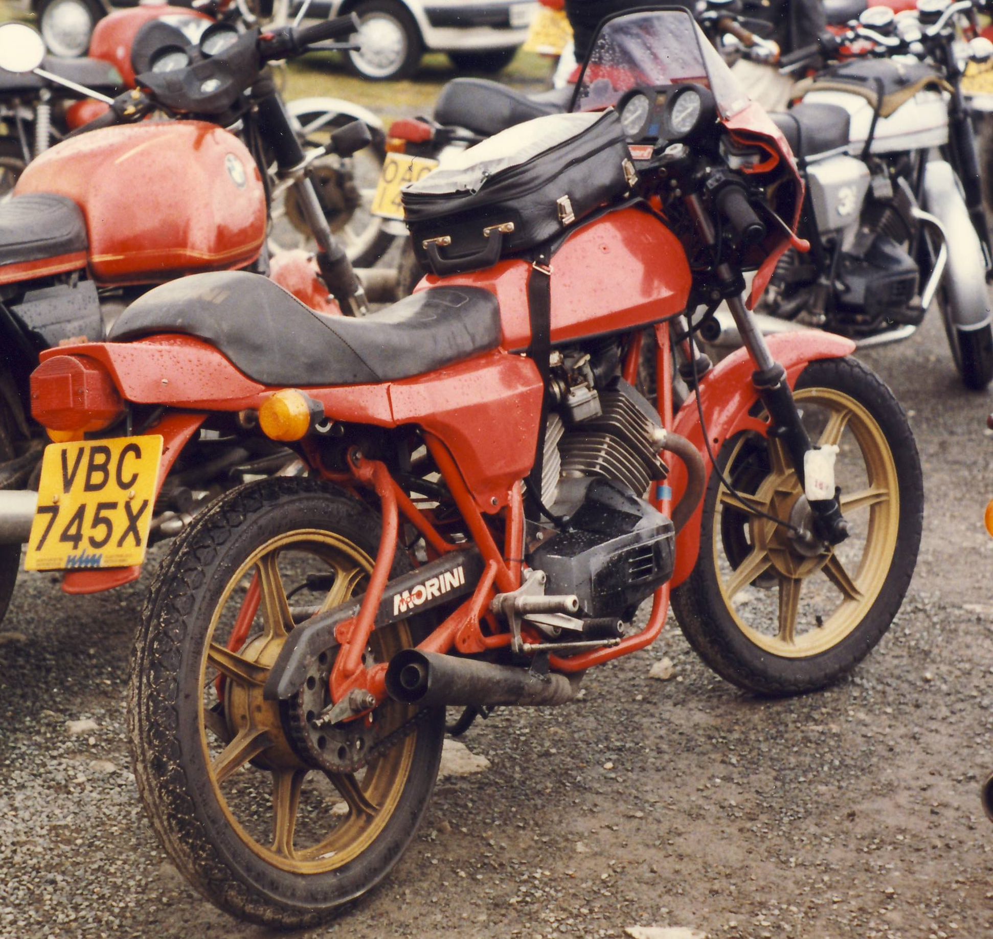

Posted: 21 Mar 2021 11:32
by julianharty
Here are some alternative suggestions:
1) If having working and functional speedos and revcounters is what you're after then I've previously fitted the instrument cluster from a Honda Super Dream 250. I used them on one of my 350 sports in the mid 1980's (it's the same bike I fitted a Yamaha LC monoshock to, see photo). I've since bought another complete instrument cluster including the ignition switch and key from the same model for around £30 - £40 (not much anyway) for when I want to do something similar. They're good enough in terms of accuracy and easy enough to obtain (there are well over 100 results listed on eBay.co.uk currently).
2) I expect many of you would prefer something more 'classic' and/or Italian. Again I've bought a new speedo sold for old Moto Guzzi's for around £50 - £60. And I've also (as harrymuffin mentioned) bought an Indian speedo on eBay.co.uk for around £15
3) And if you decide you'd be up for the fully electronic units then I've used a Vapor combined speedo and revcounter on a Kanguro. The main challenges of these are mounting it, the speedo sensor, and then coping with the predictably erratic RPM calculations as it doesn't read consistently through the rev-range. The Vapor does have a setting which changes the multiplier it uses at a given number of pulses which helps mitigate this behavior, and there's at least one friendly supplier in the UK up near Birmingham (I've not got his details to hand).
Trimmed photo of VBC745X monoshock
