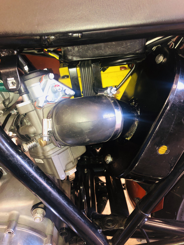

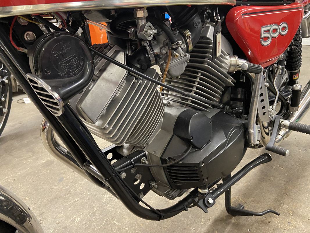

I installed the Mikuni carbs today, they slot right into the stock rubber boots, I think the air box boot even fits better than the Dellorto carbs. The mikunio have a lver choke, the one question I need to figure out is the mixture screw, its on the inside of the crab so not easyly accessable to adjust, I don't know if on Mikuni this mixture screw is controlling air or fuel?? I have them set at 1 1/2 turns out, turning the screws in or out does not seem to make any difference. Until I sort out the reg/rec charging issue ots probably a mute point.
The good news is the bike idles much smoother, it responds much better as well, a win!

Ok I finaly got to experience that perfect moment,
the 500W is a wonderful bike to ride, I have read and heard how good the Morini's are but until this week my bike was never properly sorted, now that the ignition, charging, carburatuion and foot controls are sorted its just great!
I have owned and still own a lot of different 1970's Italian motorcycles including Guzzi V7 Sport, 750S, 850 Lemans, Ducati bevel twins amongst others and this 500 is the nicest bike to ride, its smooth, it handles great and its nice and light.
