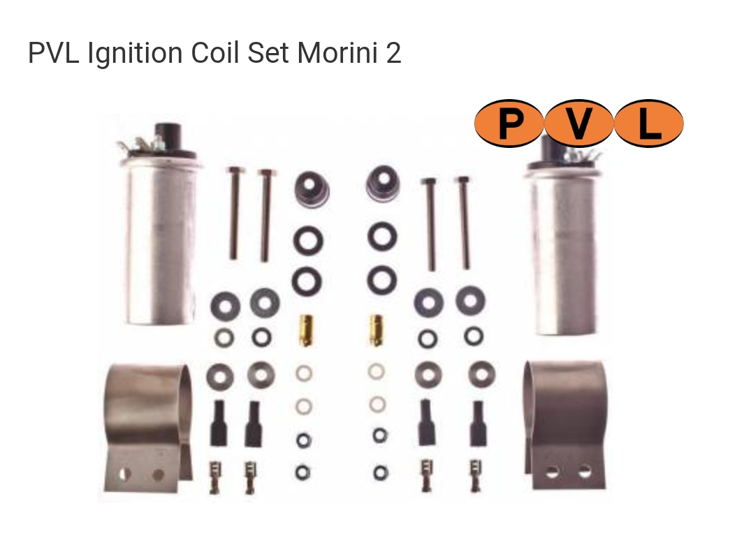

2. I've also ordered the ignition coils from Sachse which are recommended by them for use with their ignition kit (photo). These come with mounting brackets (specific for the Morini 500 I hope) as you can see, but being cylindrical I'm wondering whether these will these fit in the same place as the original coils beneath the fuel tank?
Thanks for any feedback 👍

Coils will fit very neatly under the tank, but need careful placing in the bracket - also which way round as well for clearance and ability to get HT leads in right place! Run wires carefully too...checking they are the right way to the right coil.
