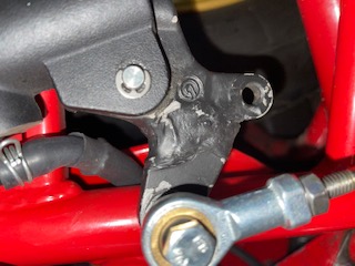

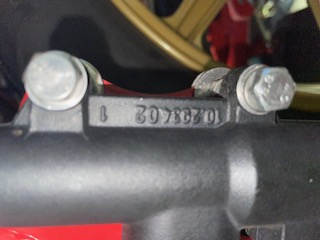

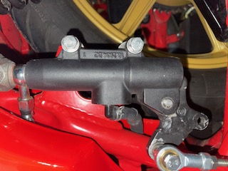

Alternatively, previous owner of my triple disc 350 fitted a new brembo master cylinder on the rear. It works well and doesn’t look out of place, although he did have to cut and weld the actuating arm to get the angles right, which is not ideal on a brake component. Part number 10.29(or maybe 28).34.02
