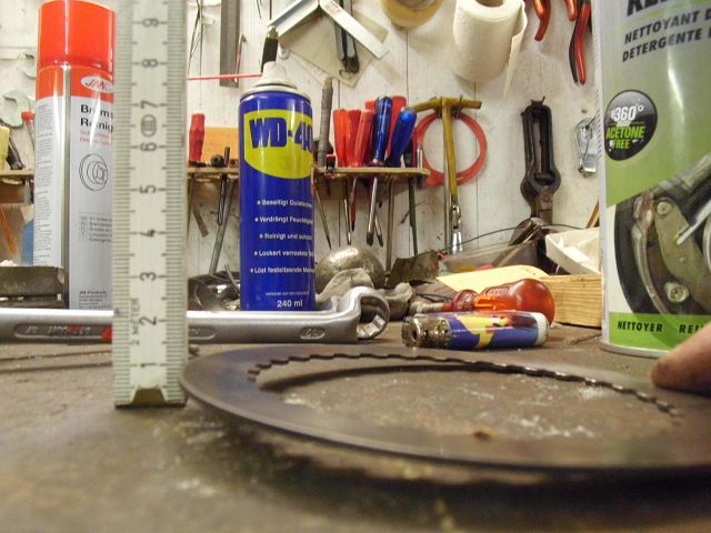

Do the enter hub have deep marks from the metal plates? If so you can pas a file to make it a bit better. And the second important thing is that one metal plates is still curved/domed! If I remember it well this plate is a bit thinner than the other ones. It used to become a bit blue from heat. If this plate becomes flat you will have these problem. I had the same issue with two 501 motors.

The bike is back up on the operating table and I'll dismantle the clutch again today. The clutch outer basket is in great condition with no significant grooves or marks in the splines. I will have another look at it though. I have also replaced all the friction and metal plates, so they "should" all be good, including that dished plate. Again though, I'll have another look and compare it with Norbert's photo - thanks for that! I will also check for float now that everything has had a chance to settle down after re-assembly.

I did get it reassembled yesterday and I found two possible issues. First I now had a bit of float in the clutch basket, not a lot, about 0.2mm I would guess. Second, I am much obliged to Norbert for his photo, quite a nice way to both visualise and measure the amount of "dish" to the non-flat plate. As best I can judge, his plate was tilting up about 9mm. My new plate was only dished by about 4mm in the same test. I had a rummage through my Morini-related junk pile (I'm not very good at throwing stuff away!) and I found another dished plate measuring 8mm. So, I re-shimmed the inner clutch hub and fitted the 8mm plate. I had a ride this morning and it is a lot better - not "fantastic" but certainly acceptable. I stopped and started dozens of times and it was improving all the time, so I guess the new friction plates were bedding in and improving things.

that´s fine you´ve found a more dished plate :D If it has become flat it´s realy a pain to start from being parked! It seem´s that this problem appears more often with 500 than 350, although the clutch is exactly the same (with the only diference of the bore in the center hub).
