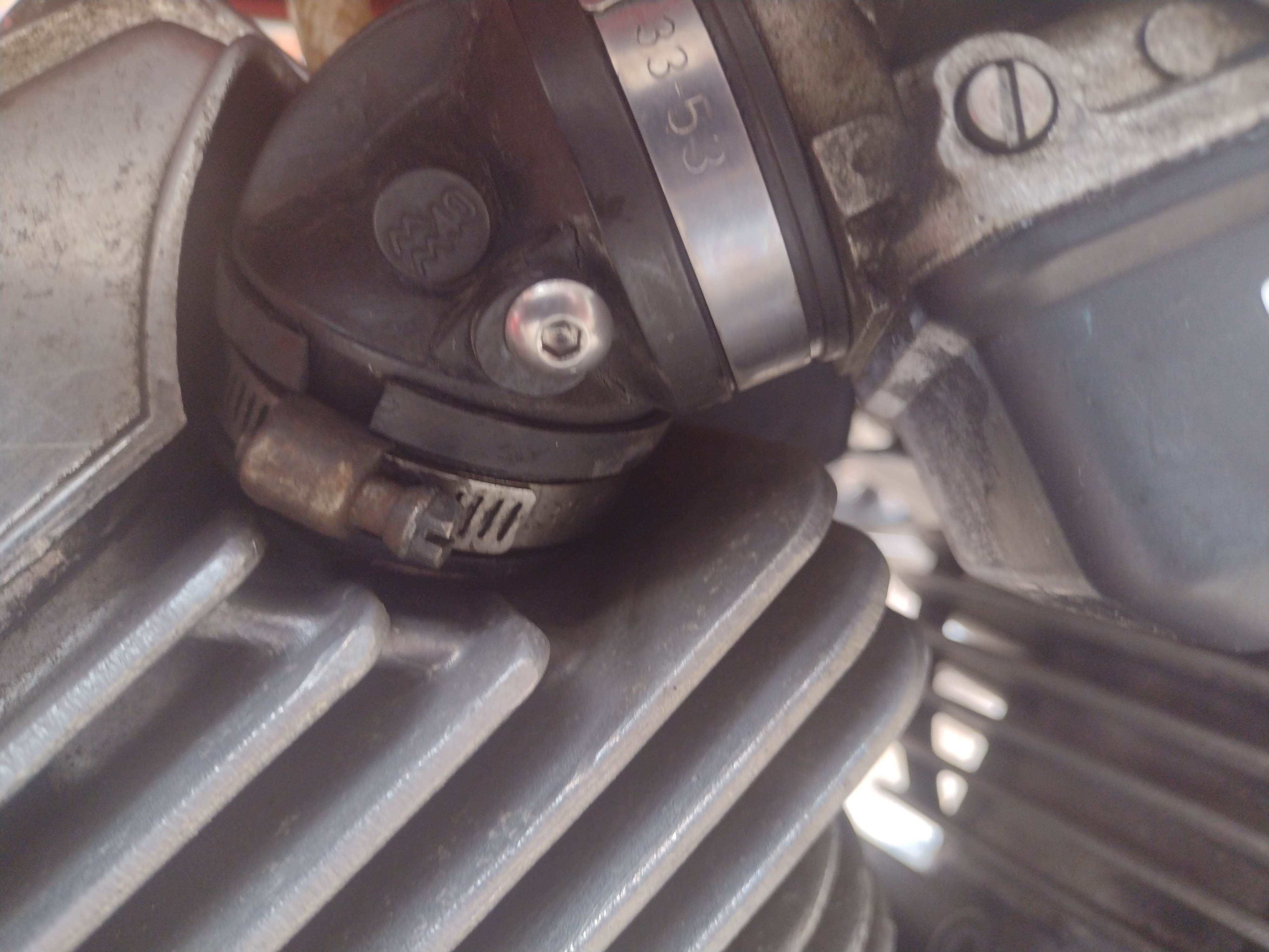

A picture is worth 1000 words. Definitely M5 - drill hole smaller than you would for tapping in to metal though.
I find 'close but no cigar' by ear and feel. Good enough for sure, but when you get those carbtune columns dipping together perfectly given a whiff of throttle I reckon you can feel the difference on the road.
You can probably drill more accurately in to the centre of the 'boss' than I did. I'm not a great one for immediate appearance over underlying form ;)
Re: Connecting Carbtune Manometer to Inlet Manifold
Posted: 21 Aug 2023 10:47
by 72degrees
Aha. That photo reveals some incipient cracking of the rubber. Almost certainly due to having no air filter box, S&B cone filters and big zip ties to take the strain. One day I will get some proper high tech supports made. Then I dare say this set of rubbers will "see me out" ;)

by norbert
I´ve done that the same way as 72 degrees and it worked without any problems for years. Just make sure that the screw does not enter in the manifold canal. If I rememer it well, I´ve added an O-ring underneath the head of a simple allen screw.
There are some special "plugs" to seal the hole in the rubber. But I prefered the solucion with the screw :wink:
The cracks in the manifolds for not fixing the carbs when not using the normal air box normaly begin in the fold where it is put on the cylinder head. They advance from inside to outside, so you cannot see it from the outside by the right time. Normaly you notice it because it´s not posiblle to achieve a correct idle. Then it´s time to have a look at the iside of the manifold.
