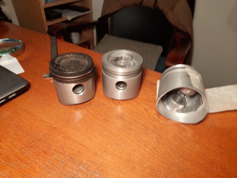

I do have a pair of new old stock 71 mm pistons without rings for iron cast cylinders. They have been made especially for the Desert Ralley Camels (Paris-Dakar etc.) that have been used by Valentini & Co. I would sell them, but not sure about all the shipping/custom problems :roll:
The left one 478ccm, 69 mm diamter, 268 gr, with rings
The right one Paris-Dakar piston, 71 mm diameter, 261 gr without rings, for “478” ccm cylinder

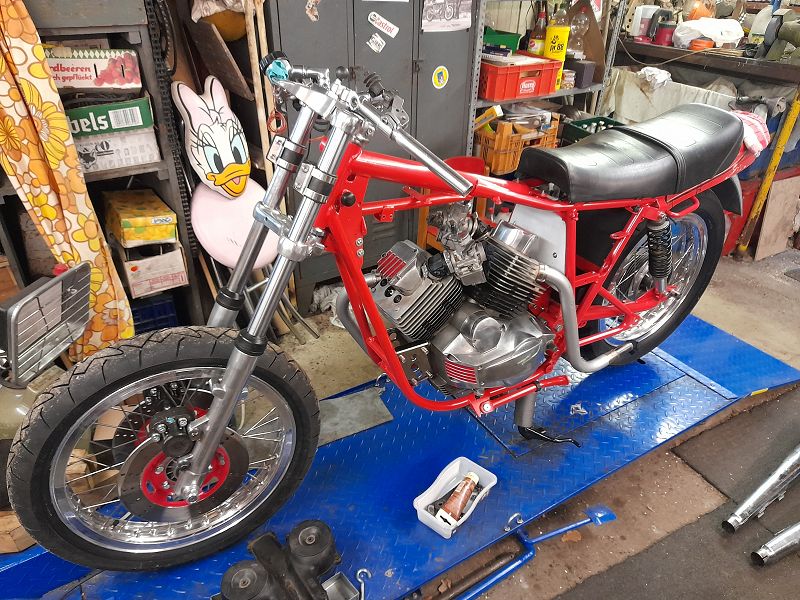

My tuned 500W has 501 barrels, 501 heads, a L5 cam and of course PHBH 28. But as said, these parts are dificult to find and not cheap!
This motor will end in what probably will be my last project: a "pensioners bike " with heated grips, electric starter (my fist one ever) and after more than 45 years with clip-ons with a Brevetatto handlebar to rise it up a bit every year :wink: :lol:
Without doubt the 501 engine (if posible with L5 (II)) cam is the best series motor, followed by the one from the 400 Dart and then the 350 Nikasil motors with "M" cam (X2, X3, Excalibur 350, K2(do they have M cam?). The cheapest way would be one of these 350ies maybe with 500 headsand 26/28 Dellortos

Thank for the details. Is this a 501 engine complete or one with a 350 bottom end? Also, love the wire wheels and discs. They look ideal but dare say difficult to get.
Posts: 927
Re: changing capacity to 501
No, as said above, it´s a 500 (478ccm) 6 gear bottom end with 501 cilinder an heads plus a L5 cam. The rims are brandnew ones from Morad/Spain bought 15 years ago.
