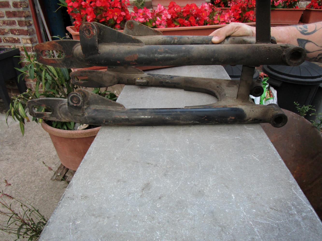

Hello ,
I just have a look at your subject . In fact 300mm between centers are only for 350 .
On the 500 the rear fork is longer + or - 60mm compare to the 350 .
Than on the 500 the shocks the lenght is 320mm between centers .
Christian , 123 .
- Top is from a 350 and of course the botom is from a 500 .
- IMG_0693.JPG (189.22 KiB) Viewed 2688 times

Here are photos of the lenght of shoks .

Re-re ,
The lenght of the 500 ...
Christian , 123 .

Judging by other posts on the forum & my own measurements, something nearer 312mm eye to eye is correct for the 500
