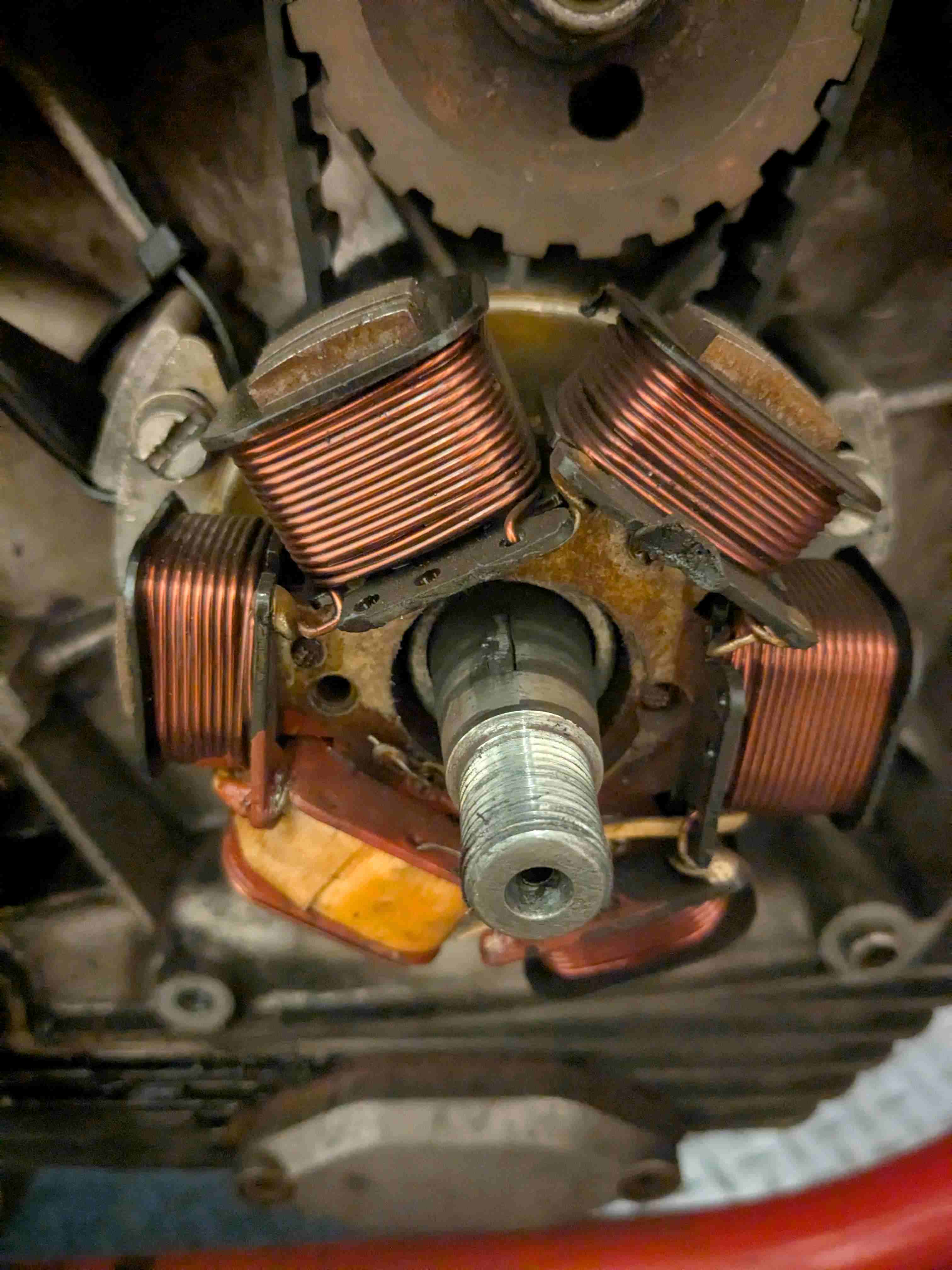

Well it looks like my roadside failure was as a result of the rotor coming loose & sheering off the woodruff(?) key, so a few questions:-
1. what size key do I need to refit?
2. Do I need special tool whilst torquing up?
3. What is the torque setting?
Thanks & looking forward to getting back on the road.

Re: Rotor refitting help
That's unlucky-but remember it isn't just the key and nut that holds the rotor secure-the taper is the important bit. The key is a fairly common size but the dimensions escape me for now, I'll try to find it. In the meantime you need to take a good look at the taper in your flywheel and on the crank. With a bit of luck you could lap it in, using fine grinding paste (remove the remains of the old key first) to recover it. Hopefully it wasn't loose and fretting for too long before the key gave way?
For torque settings and possibly key dimensions you need to get a manual and parts book. The manual is available online here (somewhere!)
meant to add-yes, you need to hold the flywheel from turning against the torque when you tighten the nut.

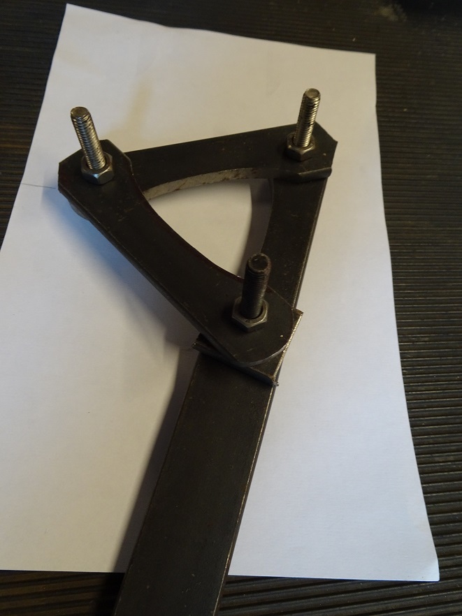

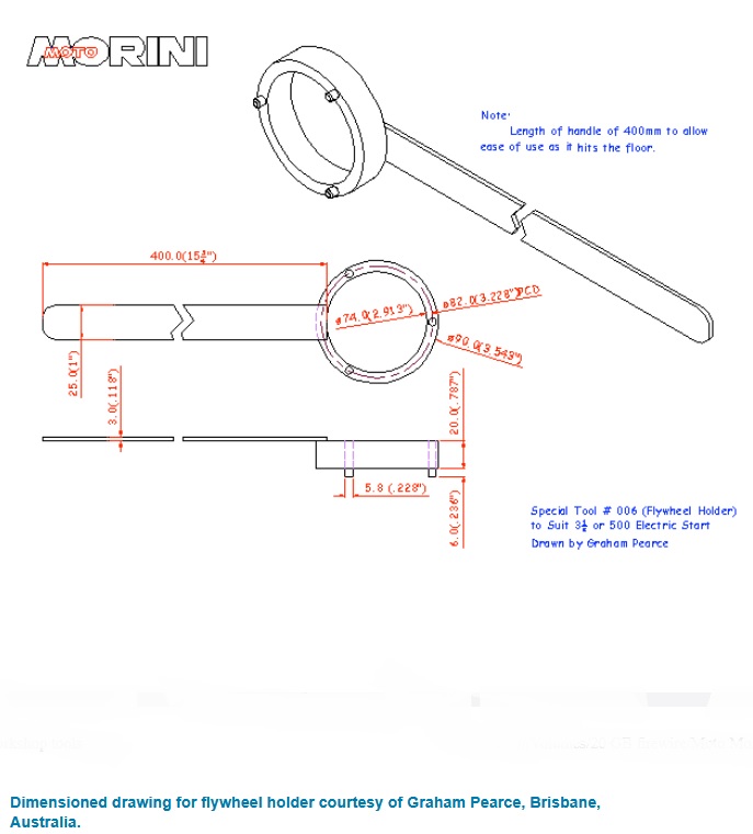

I recently re-fitted my rotor after fitting a new cambelt. The 'Blue Book' recommends a torque setting of 6.5Kg/m which equates to 47.021 Ft/Lbs.
As Steve said, it is very important that both the external and internal tapers are scrupulously clean and undamaged.
You will need a holder to steady the rotor while you torque up the nut. My rotor has three holes but I think earlier ones had two.
Attached is an image showing the dimensions of the holder, and a picture of the tool I cobbled up which looks a bit rubbish but which worked a treat.

Thanks Morini Jen - will see what I can sort out, seems to think the club may have tools to borrow?
In case of emergancy (on the road ...) put in the 6th gear and step on the rear break to hold the flywheel
I made one out of some wood (about 12 x 2cm) drilled in the centre to allow a socket to pass, then suitable M8 bolts at the right point to fit. Cheap as chips. That taper must be sound as already said. Of utmost importance.
