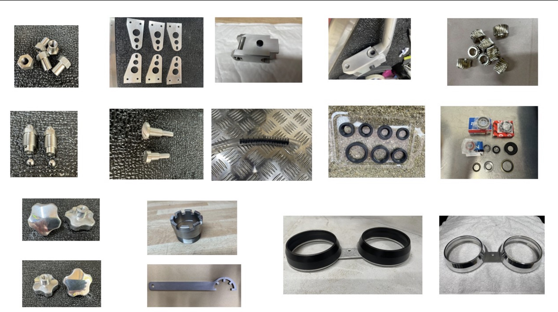

Posted to Australia a few times ,Olly makes a few bits for Morinis see below

Brilliant! :D
That's what you want...
I have bought the hexagon head clutch nuts and an exhaust ring spanner from Olly and the quality is absolutely superb.
