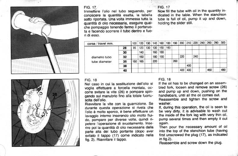

MK 1 Camel handbook states 333 gr per fork leg Castrol TQF
Once filled take the weight off the forks so they are fully extended before closing the small Allen air bleed screws in the fork caps; they need the volume of air inside to function properly.
Enjoy your Camel
