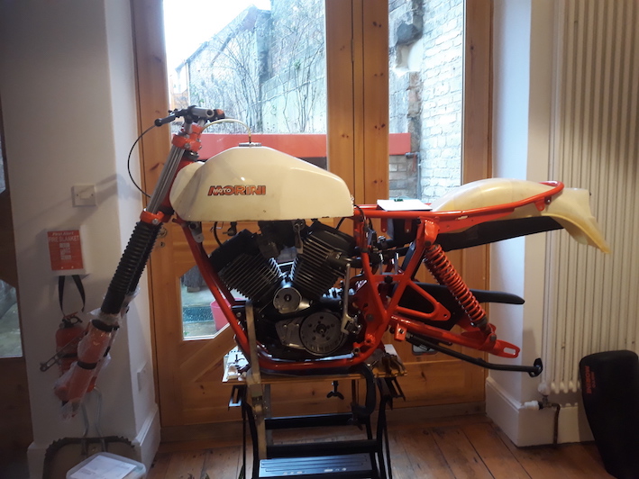

Coming together very nicely, but I'm looking forward to getting it muddy.
And sorry about the mudguard Steve.

Nice one. Had it long ?
I also want front fork gators like yours.

Sheikh wrote:And sorry about the mudguard Steve. Hugo
I'll never forgive you! I hope you checked he didn't have a box full in his van :?: Your cowling is still here with me at the moment. I'm not holding it for ransom against a rear mudguard-honest. I just haven't managed to get the geezer to answer the phone yet :roll:
Your new bike looks great too, it looks like you made the bash plate already? And what are those rear shocks?

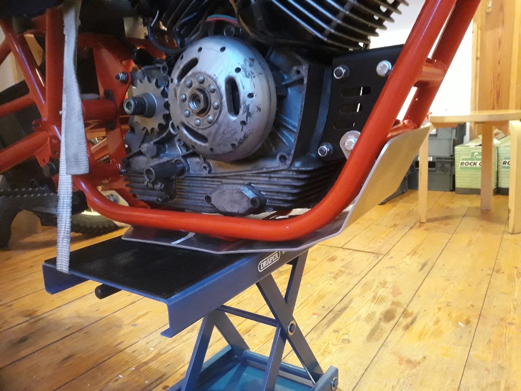

Any close ups of bash plate ? Thinking of doing one for mine.

Bash plate is made from 3mm ally by Scott Carpenter. It fixes to the lower front engine plate fittings, and to the centre stand fitting at the rear. Obviously that means that you sacrifice the ability to fit a centre stand, but having a flat base means that you've got a decent means of supporting the bike on a bench or bike lift. I wish I'd fitted one sooner. The lower tubes on the other Camel have taken a pounding.
I would like to modify the footrests. I like to run with the 'rests in quite a low position but that means that the cleated section isn't parallel to the ground so they dig into the instep of your boot when you're standing. It'd be easy to cut off the cleated section and re-weld in the correct position but I'm strangely reluctant to sacrifice a pair of the original chrome plated pegs from the Camel. Does anyone have a damaged or spare set that they'd sell me? I guess they are the same on a Kanguro. Or is there an off the shelf option?

Re: And another Camel
Post by Sheikh »
Oh, and rear shocks are cheap Sebacs that came with the bike. I'm expecting them to disgorge all their damping oil as soon as they're asked to deal with anything substantial. The other bike has a pair of NBS shocks which are a bit soft, but work OK.

Very nice. I may try to keep the center stand, so might try to cut a small one the fits between the down tubes. I will be careful not to bang into big rocks.
