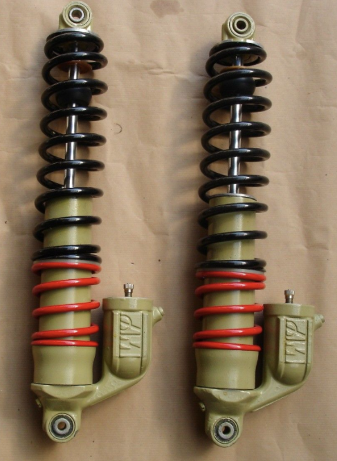

Re: Camel Marzocchi`s
The forks are Marzocchi Piffero 38 mm. The rear shocks are Marzocchi AG4 and not the MX580!

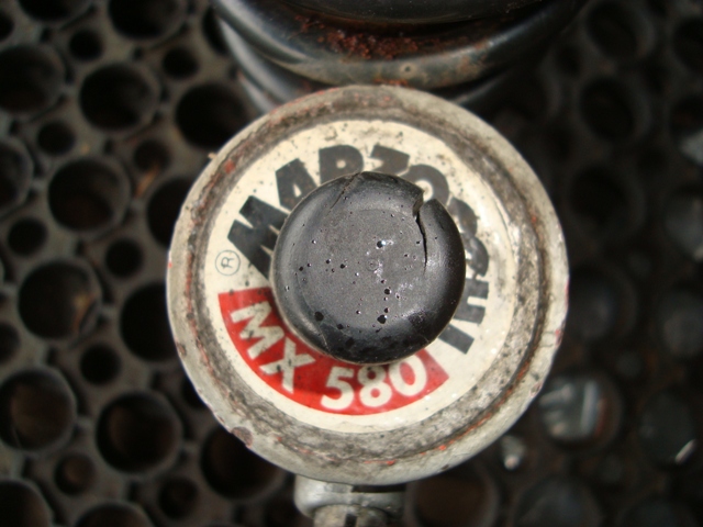

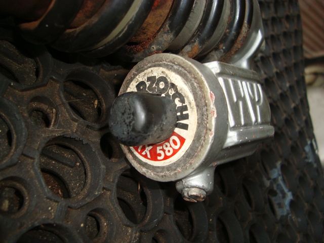

Hi Angelo, thanks for posting the AG4 & MX580 photos.
All my Camel shocks have MX580 decals and look exactly like those in your photo of AG4 (gold) shocks.
The red pair with the adjustable pre-load look the same as the illustrations in the MX580 maintenance manual.
This is all very confusing; do your AG4 shocks have MX580 decals?
Take care, Ian
Take care, Ian

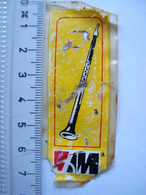

Hi Ross, it appears that your Mk1 Camel originality fetish is gathering momentum.
I also came across the original sticker from my forks which I removed in the 1980s when I painted the sliders.
This was the only decal and located on the lower left slider.
Trust this helps, enjoy the quest, Ian
Yes, the sticker of the fork is correct. It is the Marzocchi "Piffero", that means fife, the musical instrument.
This one.
