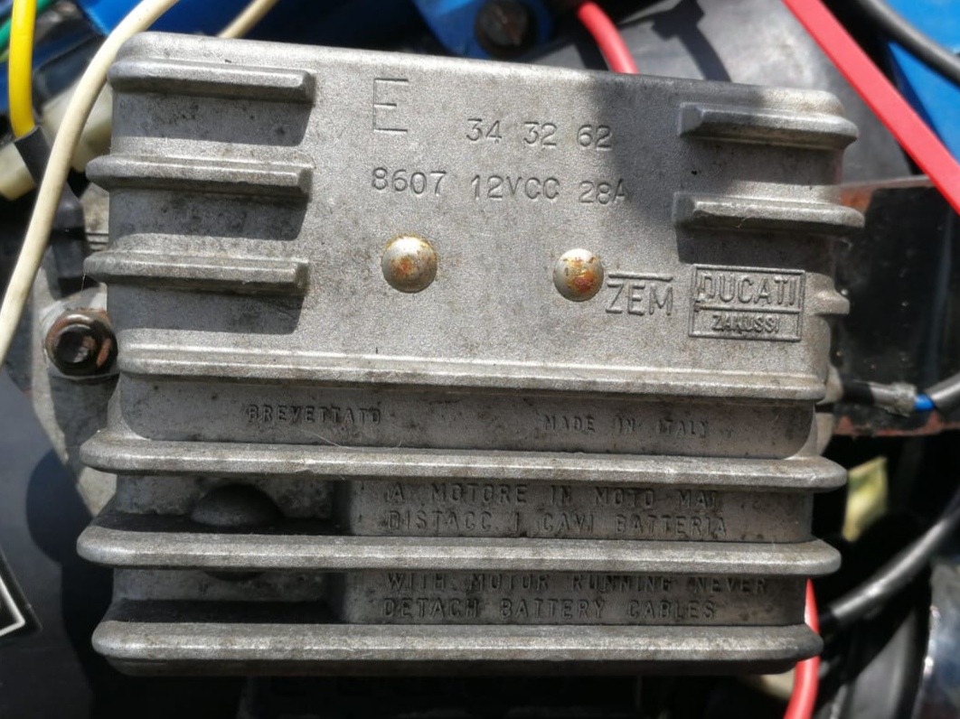

Hi anyone tell me why my regulator decided to melt? Just restoring a 501/2 had the ignition coil rewound by Rex's speed shop put 2 new transducers on (blue type) and within a minute of starting the bike the regulator started to smoke fron the top rear left side.. Is it just a faulty unit or is something wrong with connection to the battery (i didnt have time to check the input at the battery) .

From the post we can't tell what kind of charging system you have.
Is this a non Kokusan equipped 501 mk2 Camel XE
Can you share picture of regulator and connections.

Thanks thats a good pointso heres the rectifier...i have checked continuity from unit to batter and its fine continuity from the positive connect to one of the generator terminals is dead (the one closest to the red connection... It is pre kokusan

Please add a photo of the connections on the regulator including where the smoke appeared from. This photo might help folk to assess what happened, or at least how things are connected.
