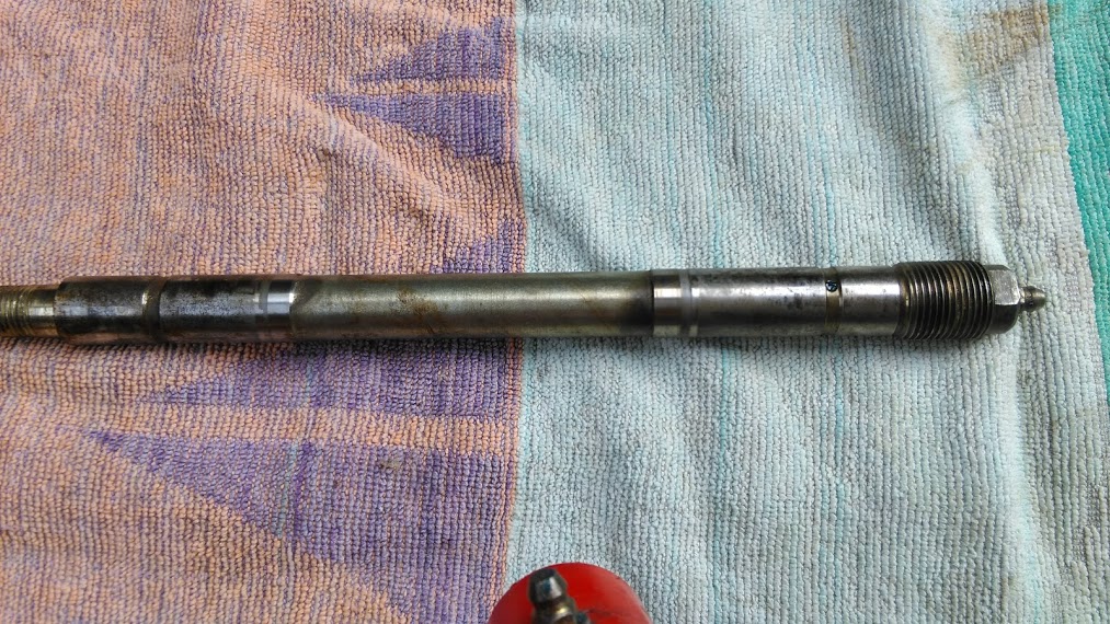

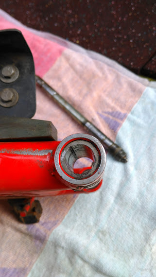

Here is mine. Im sure my bushes are steel.
- swingarm2.jpg (247.32 KiB) Viewed 12903 times
- swingarm1.jpg (45.49 KiB) Viewed 12903 times

They do look like the original steel bushes which don't last long.
Re: Swing arm spindle
I didn't know the originals were steel. Why would they make them out of steel ?
I guess that was the practise of the day.

Original bushes were sintered iron. The club did do PB bushes but they would last the same legth of time as originals. The spindels would only wear on one side owing to the production of grinding paste. The spindels are 18mm diameter and the wear is usually around 0.5mm so you can use the original spindel by turning down to 17.5mm which will not impair the chance of shearing. I would then obtain Igus M250 plasitic bushes manufactured for no lubrication situations (farmers machinery) but water helps. These spindels are made from a plastic that has a low hydroscopic take up unlike nylon variations. I used to do this as a refurbishment and my own daily bike had around 35,000 miles with no sign of wear and no movement. The bushes idealy should be fitted tight in the trunions to close the bore down so the spindels should also be tight on initial fitting, the theory being that a very light deposit from the bush coats the spindel and so effectively you have plastic rubbing on plastic once it is bedded in. No arsing about with reamers etc, fit and forget solution. Did quite a few for people once a time aand have just done for someone.
