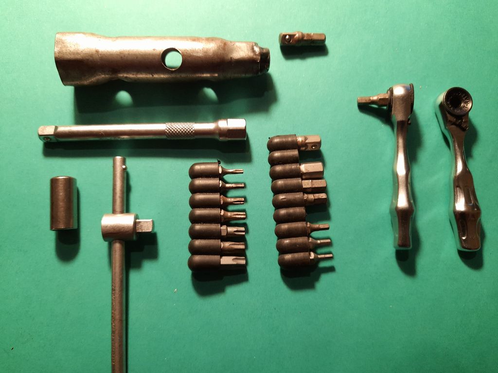

I use a hex bit from a 1/2 drive set. The top end takes a 10mm spanner and is large enough to be spun with your fingers.

I can highly recomend this 1/4 " "Mini-Ratsche" from Wera. It´s very good quality, not cheap, but worth each penny.
The hex bits enter directly and with an adaptor you can une "nuts" (that´s how we call them). I´ve solderd a 6mm one, that I never use, in the old sparkplug-tool. With this you can even get out the rear plug of a camel 501 without trouble. And it´s very nice for travelling. Less than 9 cm long. The Ratsche has 72 teeth (if i remember well), so working where nearly is no space at all :wink: It´s called "Wera Zyklop Mini".
In the last 5 years it has become one of my most apreciated tools.
