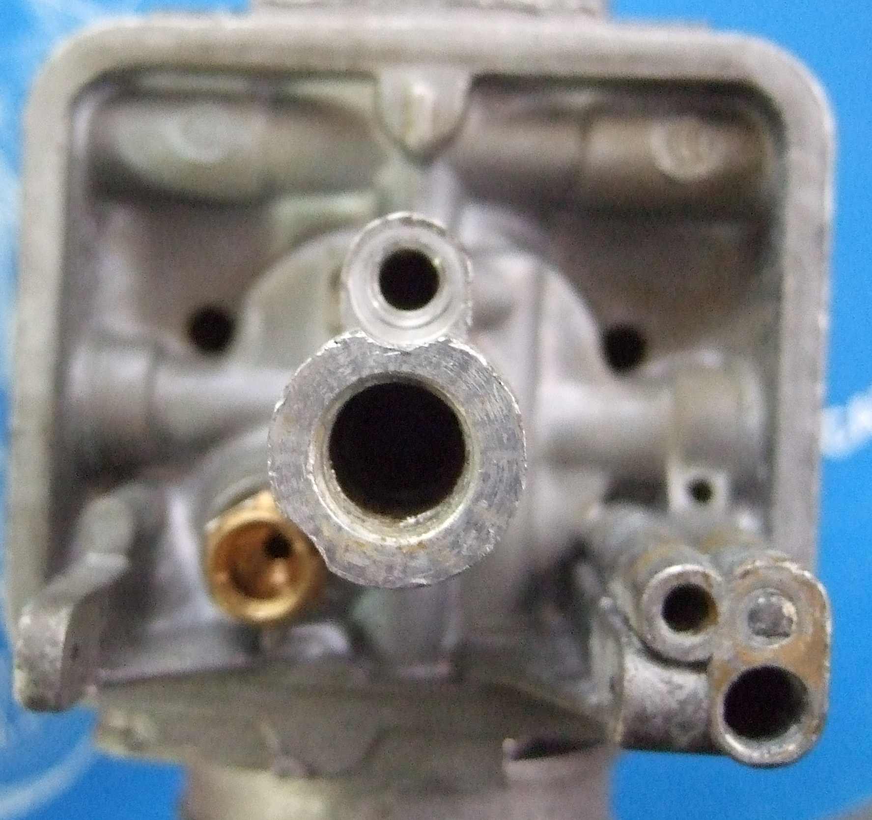

All,
I have a healthy spark on the 501, so now onto the carbs. I have a couple of sets of 28mm carbs, and I know the carbs that were fitted to the bike were this type in the pic below. Note the extra "jet hole" next to the choke jet (the carbs are date marked 1985) What is it for? and therefore what goes in there or should it be sealed off. The other set of 28mm carbs don't have this extra hole, and have a later date stamp.
The only Dellorto reference I have lists USA spec 501 camels with 30mm carbs, so I have set up the carb as given for an excalibur 501:
X18 needles, 76 main, 42 pilot, 50 choke, BC264 atomiser, 250 seat - but I don't have any 9.5g floats as specified, I only have 11g floats - are these ok?
the other set of carbs probably had 112 main jets
and what about float height? - I'm working without any workshop manual as a reference.

I am not sure where it is located inside the carb but there is an overflow somewhere. The pipe on the Excalibur used to end towards the headstock, if I remember correctly. So, could it be the overflow in case the needle jet sticks. On my 350 the petrol pees out all over the engine... :)

Not sure what the extra hole is, sorry. I'd say regarding the carb jets that the main sounds pretty small. The 30mm carbs also had an acceleration pumper jet and were a bit notorious for setting up, most went to the US I think for emmissions rules there. I had a 501 Camel for a short while that was hopeless till I tried a set of 28mm carbs with jetting similar to the spec for a 500W (or road versions) So a main of around 125 was used.
The airbox and any noise restrictors present will have an effect too. I can't remember if the 501 Camel had a flowerpot restrictor like the Kanguros did, but that would make all the difference. Most people remove that and up the main jet to suit.
the 30mm carbs also had an acceleration pumper jet
PHBH carb? then its the accelerator pump feed drill way as Steve says, the carb has an extra screw to control the accelerator pump?

yes phbh 28bs carbs, but no extra adjustment screws

Hi, I don't think accelerator pumps ever were fitted to the 501 engines as they use the smaller PHBH type carb
Without taking the carbs off my bike to look, I imagine that the hole is for air/petrol overflow if the float sticks?
The carbs may have twol push fit small metal elbows on the main body just above the float bowl these vent the float chamber via small plastic pipes that lead to a clip on the frame. Again I imagine one of them leads to the hole mentioned?
Squirt carb cleaner in all the holes and if not blocked you'll see where they lead
I removed all the elbows and pipes on my 28mm carbs as there are none on the 26mm versions found on Morini 500 engines
I think there are at least two different engine breathing and emission arrangements on the 501 Camels depending on the market/country
I wouldn't worry about it, just get the carbs clean, tune in and enjoy

Ref the pumper carbs-they were fitted to at least some of the American model 501s and I ended up buying one here about 10 years ago. The previous owner couldn't get it running right and nor could I. So I fitted a set of carbs from a 500W and it was spot on straightaway.
If I remember right, the bigger bore pumper type was fitted with a very small main jet and some other stuff to make it weaker for US emissions laws which were getting stricter then. I think even the engine and carb breather pipes were all recirculated to the engine intake as part of the plan.
I did look around a bit to see what riders in the USA had done to fix these carbs and most had binned them and used the older type 500 carbs or switched to Mikuni or even Amal. The bike I had went to George of this club who restored it as well as a 125 Morini. Nice job he did too.
