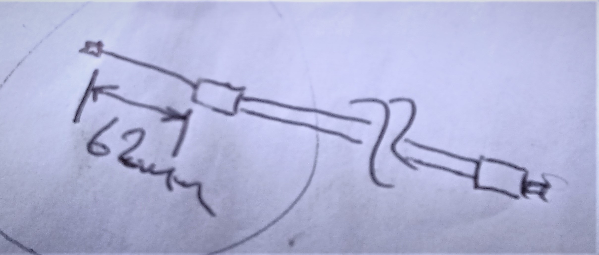

Hi Morini047, apologies for the late comment here, hope this is still helpful.
I recently made some throttle cables for my Kanguro x1. The cables described here run from the splitter 'cylinder' under the tank, to the VHB25BS carbs. The cables are the Venhill universal throttle cables kit* and I cut them very slightly longer (as I recall they may be only approximately 15mm longer than the originals).
*According to the Venhill packaging for the cable kit, they are; U01-4-101-BK Universal Kit 5mm 1.35m Black.
The left hand side carb (front cylinder) outer cable (end of ferrule to ferrule) measures 250mm.
The right hand side carb (rear cylinder) outer cable (end of ferrule to ferrule) measures 320mm.
Of more critical importance is the inner cable length, with respect to the outer cables. With the inner cable pulled out fully at the 'carb. end', I set * the length of the inner cable, between the outer cable ferrule and the head of the 3mm nipple (which links to the carb slide) to 62mm. This in practice allows the hex adjusters on the top of the VHB25BS to be wound most of the way inwards while giving just enough free slack before the throttle pulls up the slides.
* By 'setting', I'm describing soldering the 3mm brass nipple, which I sourced not from Venhill.
Cheers, Chris I.
Cheers, Chris I.
