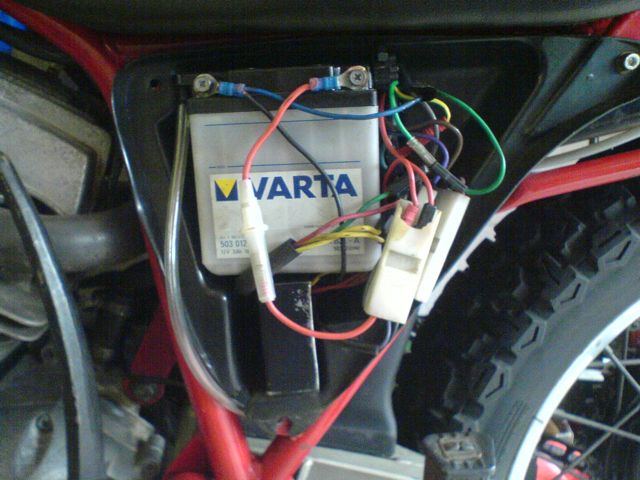

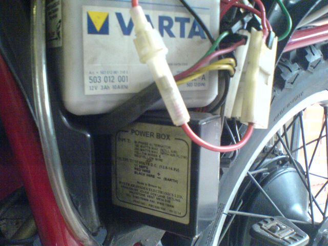

A Boyer Brandsen Powerbox is the solution on my Kanguro X and provides 12v electrics. The manufacturer's link is http://www.boyerbransden.com/pdf/Power_Box_Leaflet.pdf. I'll have a look tomorrow at the battery type and see if I can put a picture up. It's a neat setup.
Re: Kanguro X, what battery?
Here's pictures of the PowerBox installed with a 'massive' 3Ah 12v battery. No need for complicated stator rewinds, just put bullet connectors on the end of the stator leads, connect up, and junk the rectifier. A snug fit, but a fit all the same.

Some good "info" here! 12 volt conversion is a good idea as the 6volt system is a bit feeble!-the headlamp bulb, as everyone knows is12 volt and is powered directly!-a very strange mixed system! The original battery is the same as a Honda Melody-but they are now all made in China and rubbish! I have fitted one of those small round 3-cell types-will just fit the space and stay up well if you don't use the bike regularly.
