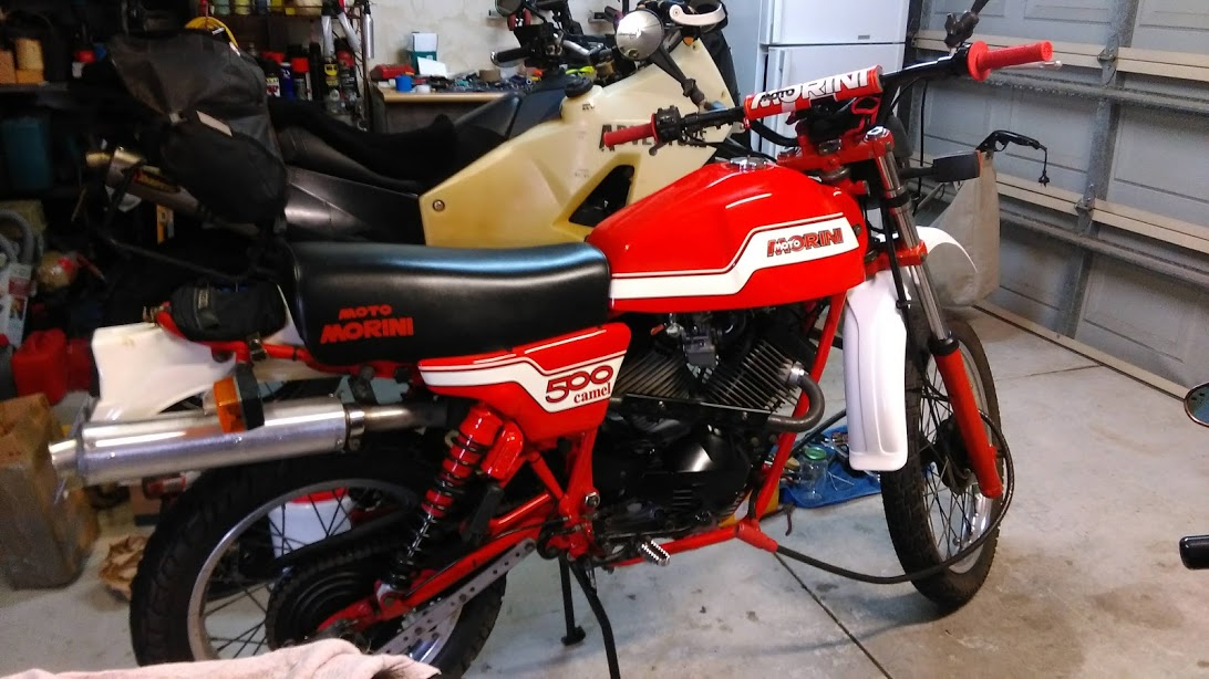

- IMAG3777.jpg (147.15 KiB) Viewed 10813 times
The handle cushion looks really pretty!
Yes I like it a lot. Thanks for getting it for me Angelo
