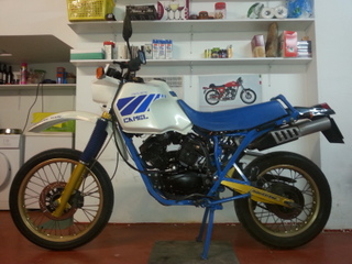

This is the first incarnation with sticky tyres , road gearing. Starter removed , battery and tray gone, X2 silencers , a long list .
Outside jobs. crank journal machined to take roller bearing on timing side , I had big problems trying to retain the plain bearing and it failed twice.
In all I took the motor apart 4 times. The roller bearing is quieter than i imagined and after 1500 kilometers seems fine!
Only other job was having the nylon swingarm bushes turned up.
I bought an early Excalibur 501 motor here in Spain and it's already paid dividends ,yielding a good stator, replacing the one on the bike which had loose rivets, something I couldn't fix .

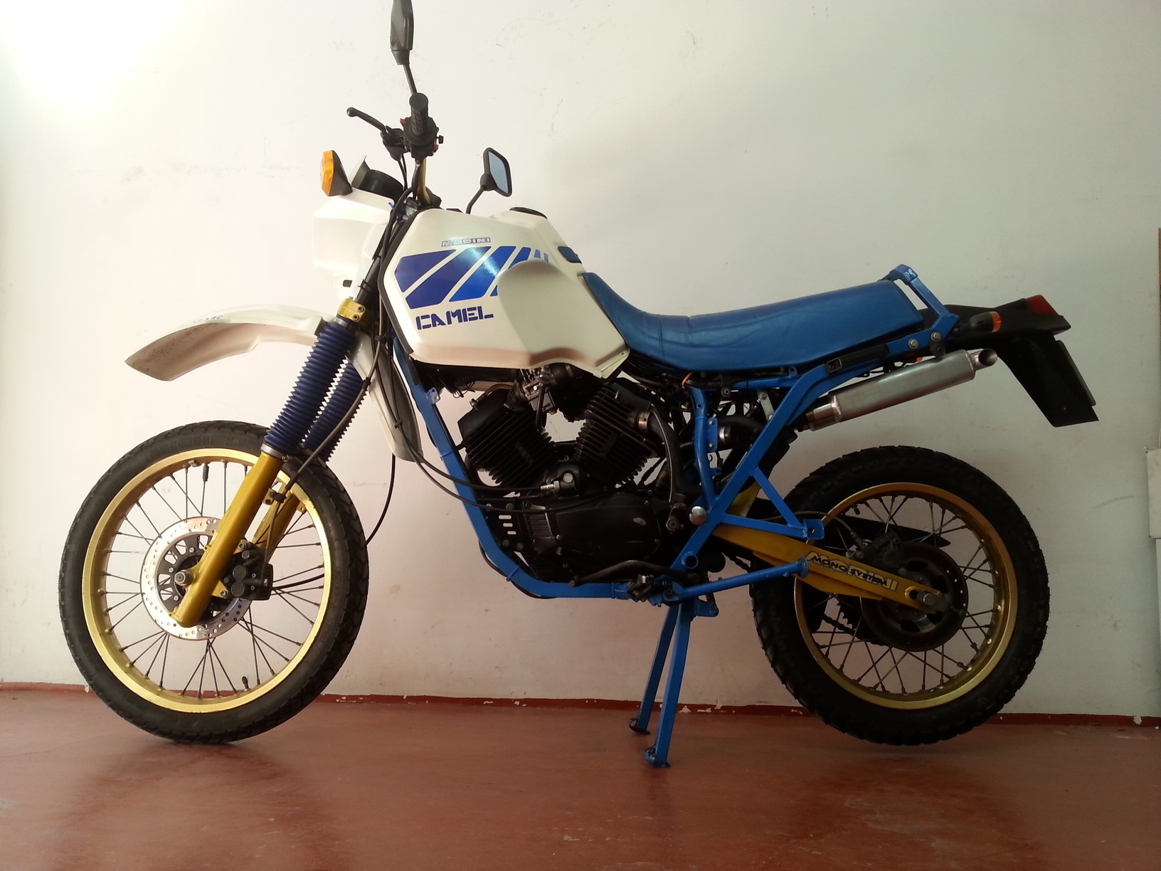

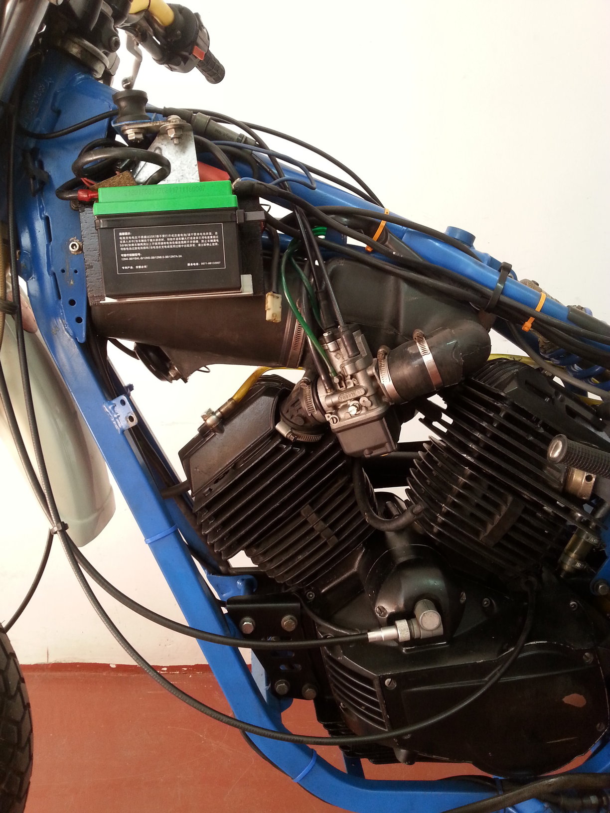

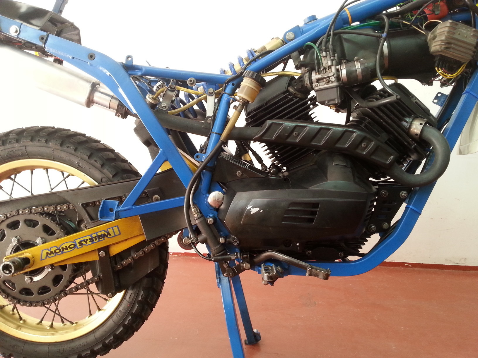

Here's the bike today.
All bits that have been hacked , chopped, removed or replaced have spares .
The most critical of these is 6" of plastic cone removed in the airbox . I'm running a 100 main jet which works well
Things removed: Luggage rack, silencers, starter motor assembly, handlebars, battery tray, battery, all superfluous plastic panels, bashplate, footpegs screen and handguards and even the horn. About 20 kilos saved with the ridiculous aluminium silencers , and 17kilos with more conventional cans fitted.
You really notice the weight saved when riding.
Starter motor rebuilt with new bronze gear and shoes relined. All electrics now work including tank reserve light , kickstand and indicator warning beeper and even the neutral light (sort of ).
Worst bit was getting the decals right , problems with the plain bearing crankshaft journal, having a clutch nut go bang in 5th gear, centre stand cracking and sinking slowly to one side, live feed to the starter shorting out on the exhaust pipe, and bits working loose or dropping off. All currently rectified until the next crisis.
