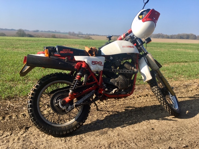

I thoughts I'd better actually put a pic up of my Camel, piccie was taken a couple of weeks ago whilst attempting a little green laning during that spell of good weather.
Camel Pic.jpg (167.73 KiB) Viewed 6604 times
Since importing her in Oct I've carried out a few tasks:
Forks stripped, new seals, upper bushes and oil
New rear Drum wheel bearings
TKC 80 tyres fitted
Chain guard fitted
Tappets set and a Helicoil fitted to one of the front tappet cover screws, new tappet gaskets for both cylinders
Correct front and rear mudguards fitted
Carbs stripped, serviced and balanced
Throttle cable shortened
Clutch cable replaced
Brighter all glass headlight and bulb fitted
Engine breather system re-fitted
Original tool tray and battery box bought and fitted
New battery
Gear shift changed to the left, rear brake lever fitted with cable etc fitted
New front speedo cable
Front caliper stripped and cleaned as the leaking fork seals had totally soaked the old caliper and pads
Spark plug gaps set
Still to do:
Service the rear shocks
Fit replica side panels, spray tank and fit new badges
Clutch needs adjusting as she's snatchy and prone to stall when setting off once warm (possibly beyond my capabilities)
I suspect I'm still not getting the best from the engine so may need to take her into a specialist for a check over :)
Lastly I've turned the shocks around since the photo above so they're correctly orientated now!
Jamie
