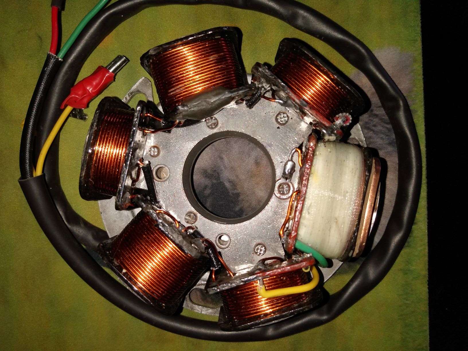

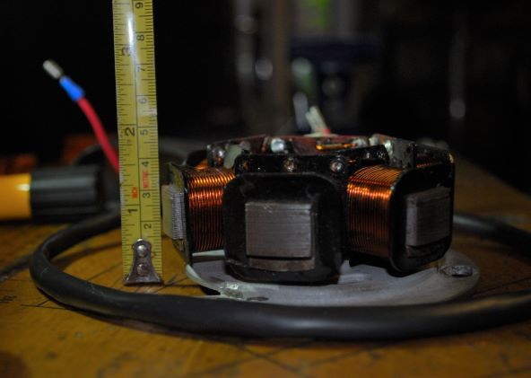

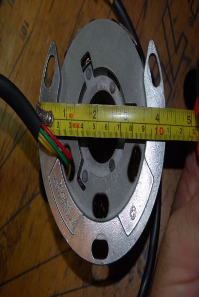

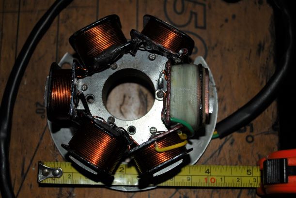

I have taken a few more pictures as it stands ignition works, rotor is fine magnet( size wise and works on a morini strada ) output red wire approx 30 AC .Professionally rewired ,they sat it is fine have they wired it as for X1 or X2 mixed 6/12v system?
Any help welcome

Before I continue, when you measure 30V AC on the red wire what's the other connection to? either of the yellow wires? And did the person who rewired it provide a circuit / winding diagram?
Thanks for the extra photos, I'm no expert on these things, however here's what I can see and suggest from the photos:
Another option is for you to find a willing volunteer (that's not me at the moment as I need to get my Kanguro wiring sorted and test the engine first) who'd be willing to test your stator on their bike. As yours isn't a standard stator then the person testing would need to understand how to test these things.
Another option is to pay for a motorbike wiring guru (there are a couple who advertise in magazines such as practical sportsbikes) to help you resolve whatever's wrong. I've never used these services, however if you can't find an alternative sooner they may be a way to help you get the bike sorted one way or another.
BTW there's a short and perhaps informative guide at https://www.motorcyclepartsstore.co.uk/ ... ectifiers/ it doesn't cover the details of Morinis, etc. it's more to help provide you an idea of how the system works and what can go wrong generally with motorbike alternators, etc.
- It looks like a Moto Morini stator.
- It's unlikely to be the X3 style, they have a sort of wider anvil at the end of all the arms but the one for the ignition coil.
- Yours seems to be wired to be a pure 12V alternator - it's hard to know without a good understanding of how each coil is wired and connected. There's no grey wire, there are 2 yellow wires (oddly to me they seem to connect to the same coil, the next one clockwise to the ignition coil which looks like it has a white presumably insulating cover of some sort).
