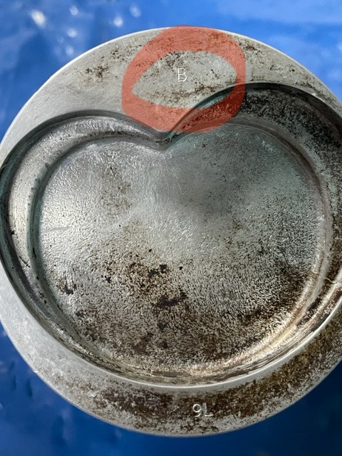

i've found the grading mark on the gilardoni barrels (A), but it is a little awkward to clean the piston tops - can anyone give me a hint as to where the grading mark on the pistons is?

The grading mark on the piston should be on the top land in the nook of the heron's heart (or bumcheek if you prefer). Here is one of my 501 pistons:

As far as I know the marks A or B on the nikasil cilinder (350 as 501) indicates a slight diference of diameter/clearing. So an A cilinder should wear an A piston. You often find the two A and B on the same motor.

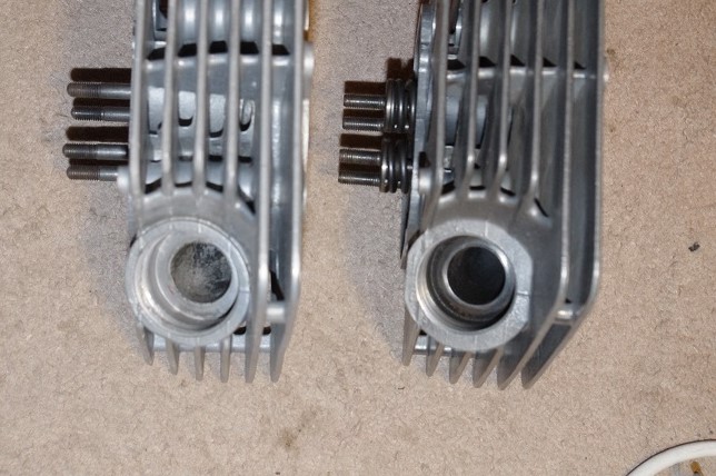

ahhh, so there are kanga-specific heads? How do i identify those from the road version?
Re: how much difference between kanguro and strada engine?
There are some Kanguro heads with bigger valves, not sure which model exactley.
A photo of the Kanguro heads I got of Ebay.de and Strada heads. These don't have larger valves, but do look 'different'.
thanks for that, it is apparent the difference when you sit them next to each other, and the strange thing is 3 of the heads are the kanga type and 1 is the other type!
