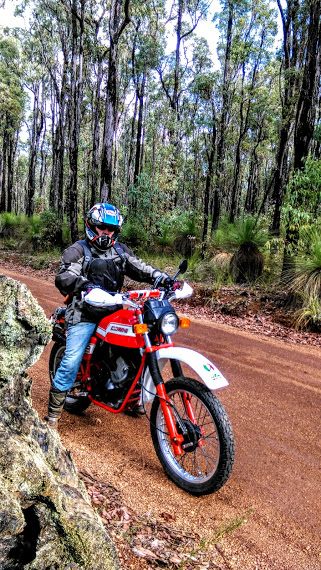

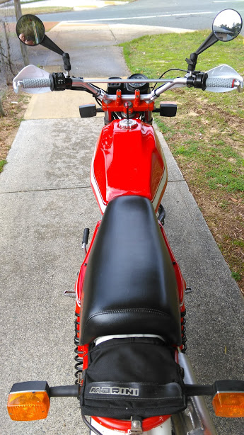

Bars and guards fitted.
- IMAG0003.jpg (230.51 KiB) Viewed 10438 times
- IMAG0004.jpg (95.58 KiB) Viewed 10438 times

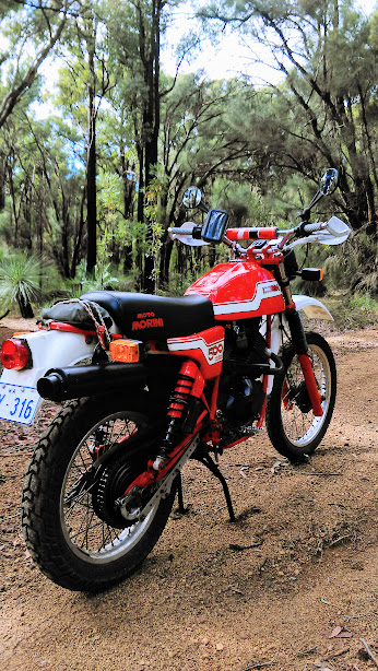

So I got to take it on some dirt tracks for the first time.
Impressions.
It handles well. Feels like a 250 compared to my 990 !
Suspension is not as plush as my 990. A bit basic, but not too bad. My hopes to get emulators in the front were dashed when Soren (Netherlands) said it`s not as easy to fit as in a 350 road forks. I may still pursue this.
Bars are a little higher than stock, but I may even fit 20mm risers. When standing they feel a little low.
May try a smaller pilot jet. There is a little hesitation re applying the throttle. Im down to 1/2 a turn out (from full in) on the mixture screw. Bike started first kick cold without choke this morning.
Really happy with it.
The not so good ?
Well the front brake is ok for loose dirt but weak for the road. I`m ok with that.
Better off road tyres will be fitted soon.
The clutch is all new and still a little grabby. Will be better when fueling is sorted. But the 2 together is tricky.
Not much else

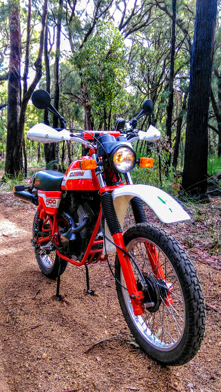

- IMAG0006.jpg (137.59 KiB) Viewed 10414 times
- IMAG0008.jpg (131.21 KiB) Viewed 10414 times
- IMAG0007.jpg (145.29 KiB) Viewed 10414 times

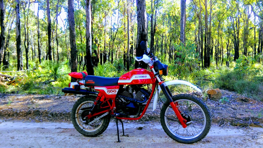

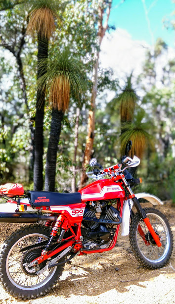

Fitted some knoblies. Feels better in the dirt now.
Todays ride was blis. Dropped the tyre pressures for dirt and it all felt quite good. Just hitting deep potholes in the gravel at 80kph I have to get off the seat a bit.
Really liking this bike.

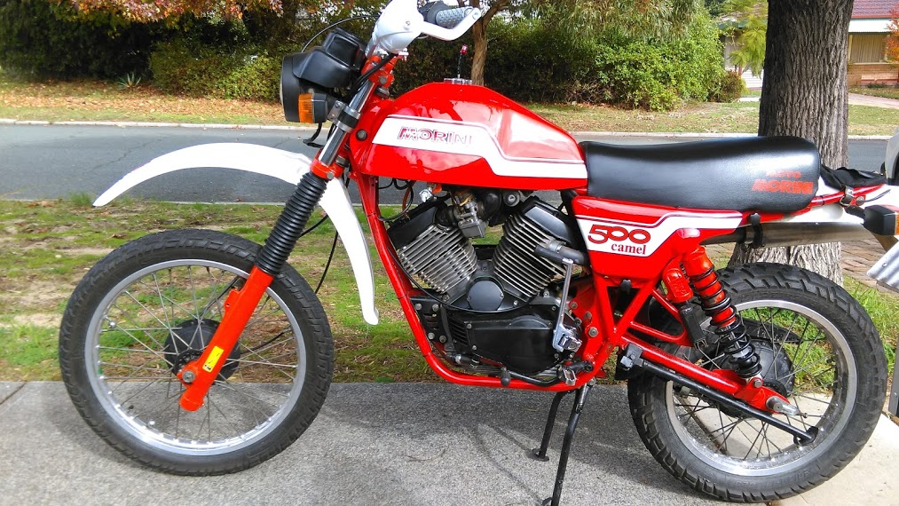

- IMAG3892_1_1.jpg (116.46 KiB) Viewed 9999 times
Rode it yesterday in the forest and still has the odd tiny stumble when I reapply the throttle. Only sometimes. But the clutch has always been very grabby. Went to bed last night thinking about it. This morning I took it apart and put the beveled steel plate on the outside instead of the inside. Fixed ! Smooth clutch now .
