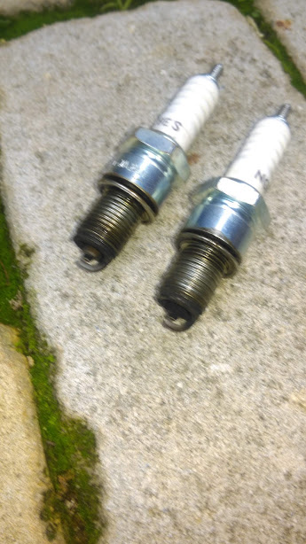

Clip is on the bottom groove. I moved it recently to the bottom one when I felt the bike was not pulling up a long hill as it should. I moved the clip to the bottom groove and rode the hill again and it was improved. So I feel I have got the needle as good as can be with this needle. Pic below shows the colour of the plugs. Not bad I thought. Back one was a bit more black than the front.
But I am wondering now if I have the completely wrong needle in it ?? May go to my local Guzzi man tomorrow and see if he has X8`s.

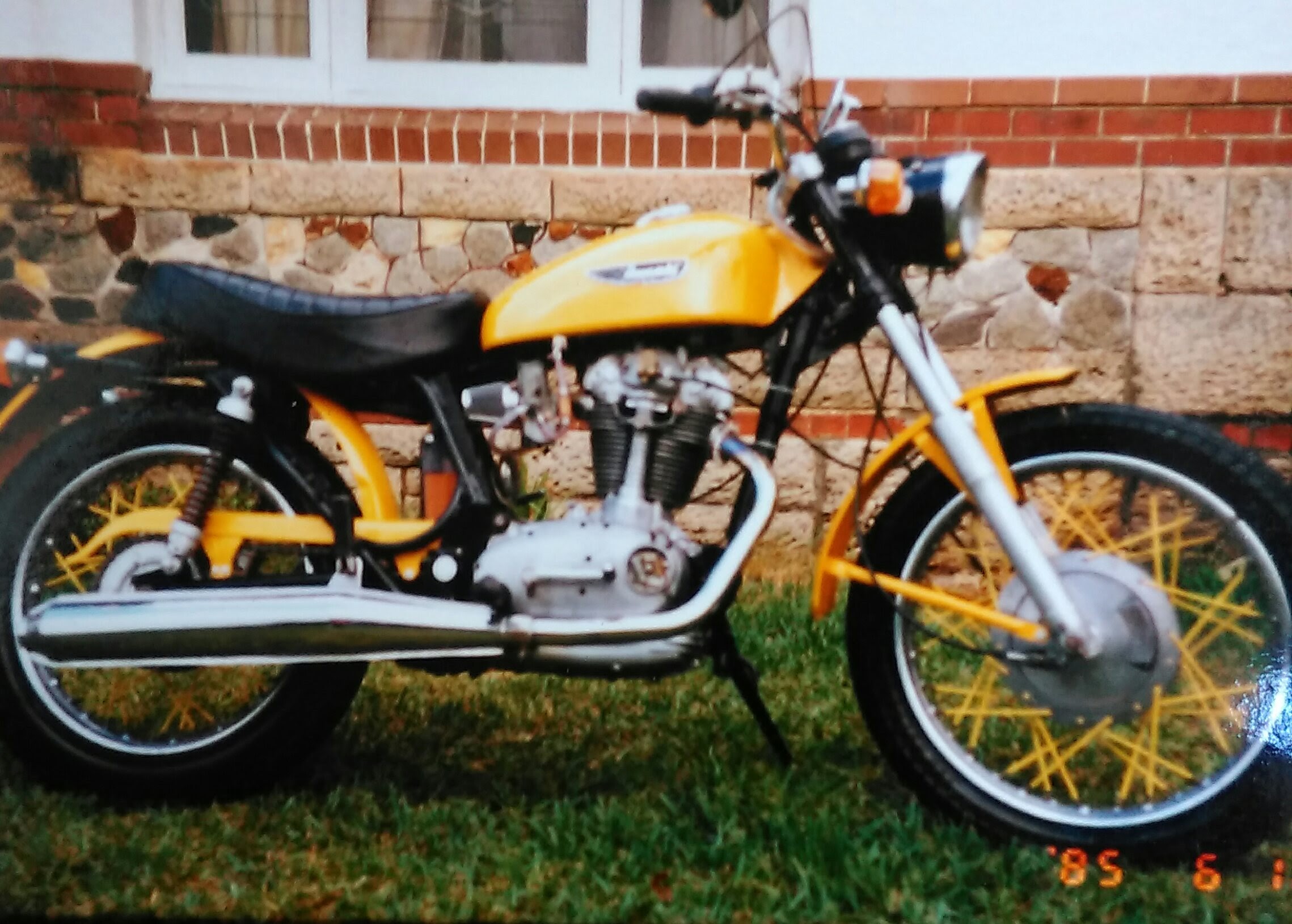

While I am here, I have a favour to ask you guys.
I am on the lookout for a Ducati 450 Scrambler frame and handlebars. Basically I owned it once (see pic) and may be buying it back as a basket case. Would love to rebuild it in memory of the last owner. RIP
Any leads appreciated.

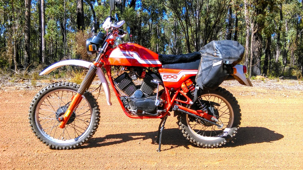

Clocked up 300 ks today. Fitted my Giant Loop bag so I can go down south in a few weeks time camping. Just needed to try it out loaded and get a good idea of fuel consumption. It ran dry at 211 kms. I carried a 5 lt container in the bag. I`m sure my tank only takes 10 lts. I get about 2 kms on reserve. New fuel taps, so they work ok. Bag works well. I needed to fit an alloy bar from the footpeg bracket to the rack to stop the bag hitting the springs etc.
I have the jetting almost perfect now. I know I have said that before, but it really is close to perfect now.
The bike is real fun to ride. Adequate power off road, a little slow for the open road, but I'm ok with sitting at 90 - 100. If I need to it will do 120, but yeh, 95 it cruises. Off road it's fun. Enough power to get the back wheel sliding out of turns with suspension good enough for most occasions I am going to throw at it.
