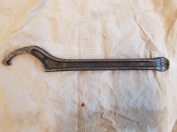

Norbert is the master, his technique I also used for many many years on Moto Morini and never lost a half ring or damaged a thread.
I present below the tool to take on your travels it is a combination MZ exhaust spanner and tyre lever.
A little grinding is needed to fit under some rocker covers and make a perfect fit.
I think they can be found for 10 pounds but better to find one marked DDR at a jumble and feel the quality.

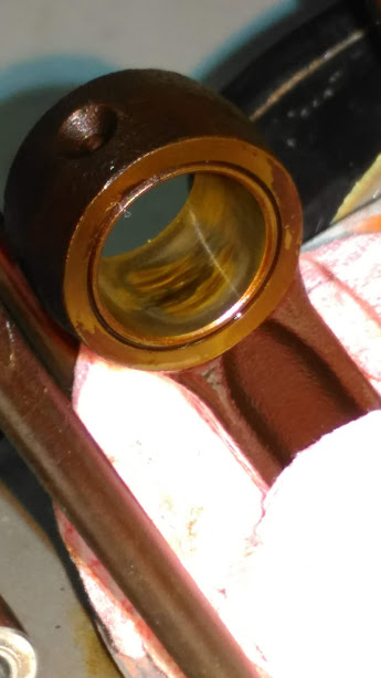

Both wrist pin bushes show strange wear marks. Front one has play where as the rear feels snug. Both have this marking. See pic.
When reinstalling the new bush in the con rod, is there a need to ream it for the new wrist pin to slide in ? Or should they be good from new parts ?
It needs to be reamed. Please refer to the workshop manual, AKA the blue book. If you are a club member it can be downloaded free from the members area.
None of the worn rods I have, all 350s though, have anything like the wear you have. what does the pin look like?
There should be a hole at the top and an X shaped arrangement of oil ways in the small end bearing.

I found in the blue book the reaming info, thanks.
The pins have marks either side of the rod. But its only one pin that has play. Yes they both have the holes and a X in the bushes. I plan to renew both. I am hoping when I get the parts, the guy doing the heads and barrels will press in the little end bushes and ream them to suit for me.

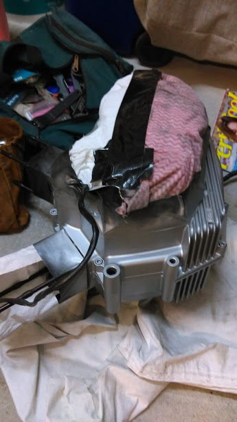

While I am waiting, thought i would give the engine a coat of paint. looks good I think.
