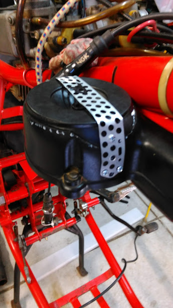

Finally got a job done that I have wanted to do for ages. Getting to the air filters is such a pain in the butt, that I have chopped the top of the airbox where each filter resides for better axcess. Now I just remove tank, unscrew the strap and pull the filter out.
- IMAG4361.jpg (72.07 KiB) Viewed 11214 times
A good idea, even more in dusty areas like yours.

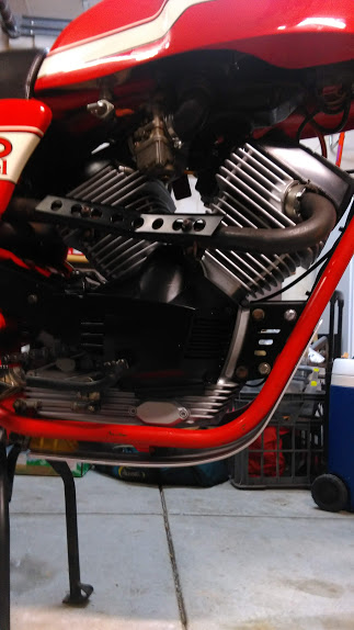

New pistons, rings, valves, seats, guides gaskets etc. Also what caused the stripdown was a buggered exhaust thread on the front cylinder. That has been repaired as well.
Also made a bashplate to protect it from stone/mud damage more so than rolling over big boulders bashing the underneath. Went around the block tonight and it runs sweet. Tomorrow I will take her up in the hills and do a shake down. I will take my balancer so I can check carb balance after an hour or so.

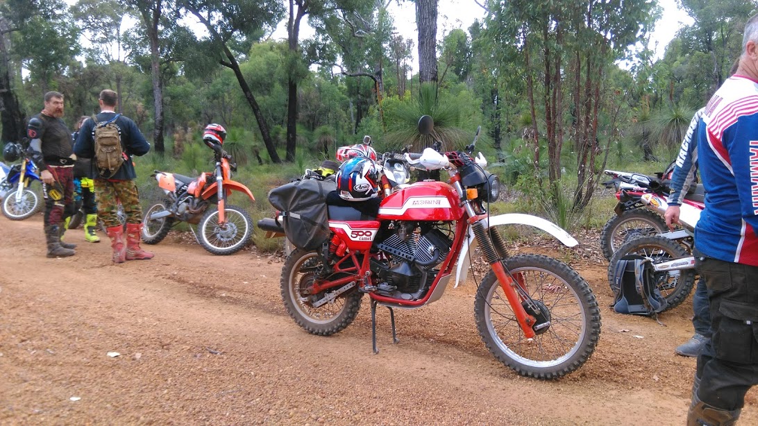

Today I rode it up in the hills and met a mate. He has been in bikes all his life. Owned 50+ bikes I would say. He is having thoughts of getting an old school dirt bike. Something like a XT500 Yamaha. We got talking and there might be a plan hatched, riding across the desert to Ayers Rock and back.
I may well NEED a larger tank !!
We have both travelled those tracks many times before. Aprox 1000 kms road + 1000 dirt roads, one way.
Would love to get a picture of the bike with a real Camel in it !

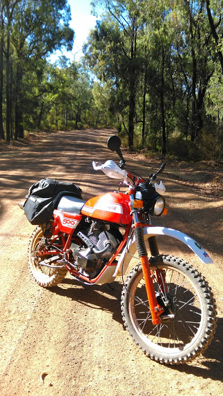

Yesterday it got a oil change. 1st since rebuild. Valves checked. Carbs balanced. All good to go.
Anyway today I was just dreaming of doing it. It travels nice at 80 - 90 on the dirt. Red dust is good for spotting oil leaks. Of which, there is none yippy !

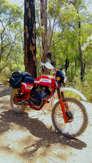

Did a ride yesterday of a couple hundred kms. 60 on road, the rest bush tracks. LOTS of gravel dust. A good test for the filters. By the way, are they washable ? I assume they are.
Bike went really well. Just a flat on the rear. Seems the tube had a crease split in it. It was a Chechaslavkian made tube ! Who knows how old. At last new tyre change I just told them to reuse the tube if it looks ok. I carried a spare and tools so only dropped about 30 minutes.
Got home and needed about a 1/4 to 1/2 turn on the front exhaust nut. This still has be wondering what is going on. New gasket, new thread and hose clamp on the pipe to stop it backing off.

Just keep retightening this exhaust nut, the day will come that you can´t turn it anymore
The new gaskets also have to settle down. And even with old gaskets the procedure is allways the same.

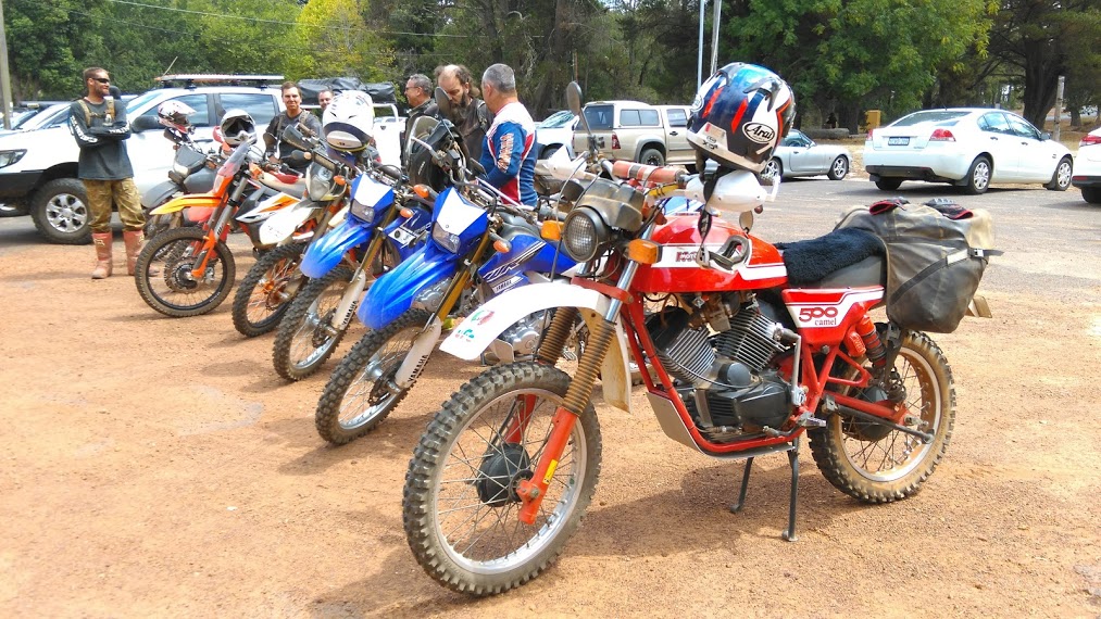

Another funny moment. Apart from the older guy on the left (who was very knowledgeable) all the rest were surprised at the ease of taking the back wheel off. Leaving the chain and cush housing on the bike was a revelation to the youngsters.
I think the bike earnt some respect
