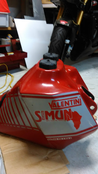

I received a tip of a Valentini tank for sale. Thanks Kamel. Im now in the process of fixing it up a little so I can fit it. Some flaking material inside needs cleaning out and a small leak. I need to move a few things around like the throttle cable splitter and coils so the new tank will slide on.
Looking forward to my 'Valentini Camel'

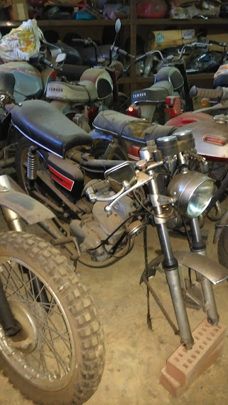

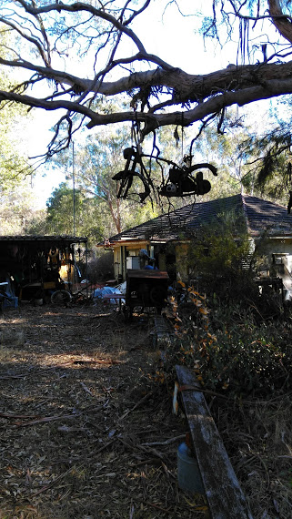

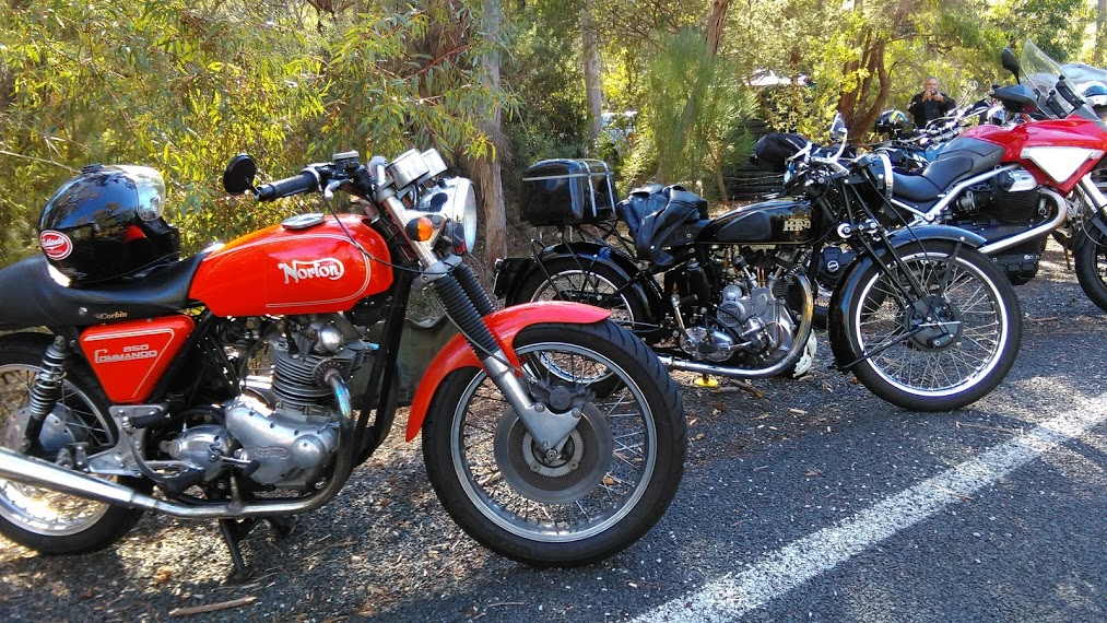

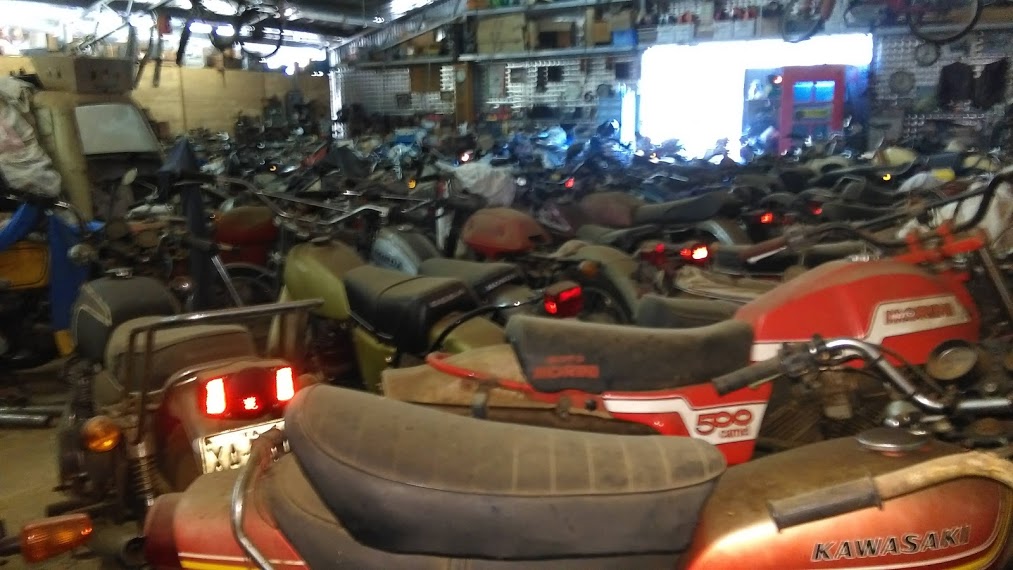

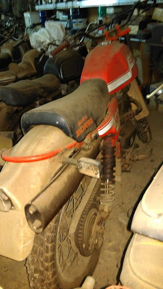

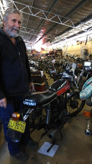

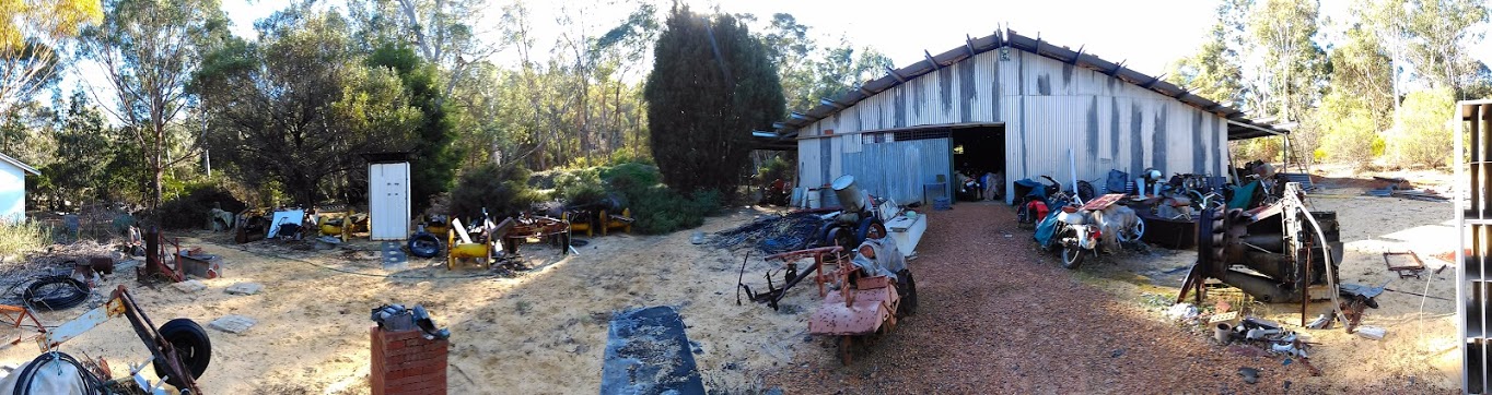

Went for a bit of a ride today to catch up with ol timers. Just a short ride out of Perth to the Swan valley then a turn off into the Chittering Valley, to see again a collection of bikes then a short ride to swap rides and a chin wag.

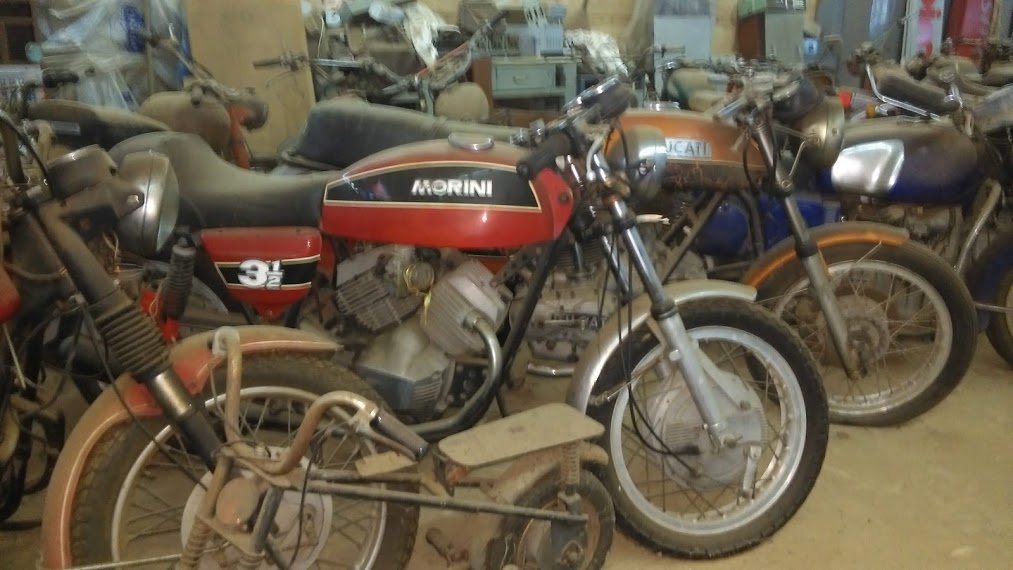

There is apparently around 300 bikes in this collection !! Tom always bought what was not in fashion and, well, just never sold things. Now it is almost sad to see the bikes, but hey, they are his and he can do what he likes.
He has several Morini`s. He says his favorite of all the bikes is his 125 Corsaro. I had one once and should not have sold it. He has 2 !! One of them has a genuine 90 kms on it.
His Camel he bought new and (he has a habit of this) attached a side car to it. He then rode it with his wife, to Alice Springs. That is in the middle of Australia. BUT, he did it on over 1000 kms of ROUGH gravel tracks called The Gun Barrel Highway. 1/2 way across the dirt the front exhaust thread came loose and before he found out a valve had burnt. No probs, he put wife on back of other bike and continued to Alice on one pot ! Around 60-80 kph !! Thats the Camel in the pic.

So my Camel is running very nice now. I got the big Valentini tank back yesterday, pin holes fixed so I hope to get it fitted soon. Will have to get the seat that came with it modded to suit.
